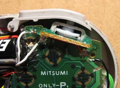

Step 5: Wire It Up!
Wire up the controller after cutting traces as per pic - the idea is to be able to solder wires to the controller pad but that the wires don't get in the way of the controller itself - hence a little of the rubber contact pad needs removing. Use kynar for the wiring as it is very thin.

You only want to connect to the button traces, scrape the traces down to the copper underneath, use some flux, and solder your tinned wire to the traces.

Not if you just wire to the traces to extend the connections; If you need to know more, please post in my forum what you want to do and achieve and we can take it from there!
Reply 12 years ago on Step 8
On controllers, yes you can cut through these traces and connect wires to extend the connections to other button contacts. If you need to know more, please post in my forum what you want to do and achieve and we can take it from there!
