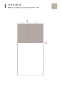

Step 1: Break Down Drywall Sheet: Mark + Score

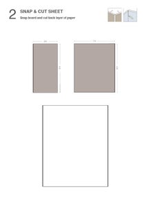

Step 2: Break Down Drywall Sheet: Snap + Cut

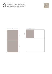

Step 3: Convert Pieces Into Components: Mark + Score

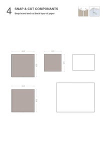

Step 4: Convert Pieces Into Components: Snap + Cut

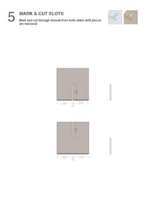

Step 5: Cut Slots in Base Pieces
Ensure you score both sides of the drywall, before pressing harder and harder until the piece is removed. Also make sure you are alternating the side you are making the slot from so as to ensure the paper edge faces the floor in the final stool.

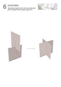

Step 6: Glue Base Together + Assemble

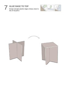

Step 7: Glue Base to Top
Ensure the top edge of the plaster is perfectly flat + smooth (you can do this by scraping the edge with a knife) before gluing the base to the top.

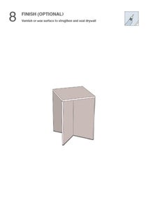

Step 8: Apply Finish (Optional)

    jugaadDo
    jugaadDo
    Reply 1 year ago
    Oh I meant a third partition. So instead of 2 partitions that are perpendicular to each other, Add another sheet so there are 6 partitions that are 60 deg to each other.
