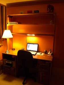

For years i have planned on building a desk to meet my needs and use old wooden boxes and crates for the drawers. I'm not a finish carpenter but was able to cobble this desk together over a few evenings with a little trial and error.
I wanted to use crates found at garage sales and thrift stores for the drawers, have a tidy cable and cord system, shelving integrated, not conceal too much of the wall, and to fit the space that i had evenly. I also wanted to spend as little money as possible on it and use salvaged materials.
I ended up only buying a few longer screws for the drawer handles - that was the only new purchase of anything i didn't have on hand.

Step 3: Assembly
Put together the shelves, outside legs and desktop. It may be a little wobbly so attaching a board on the back diagonally may be a wise idea at least temporarily.
I suggest stacking the crates you have in a few different arrangements to determine what will work best. Originally i did not plan on having the printer below the desktop but after having it on the desktop for a while i decided to move it below. Turning the crates wide side out may leave room for a desktop computer tower behind.

Step 6: Move In
I have a few more crates that i might add to a section of the top drawers but i want to use the desk for a while to figure out what i might need. I lucked out with the two pieces of glass that i had that fit the desk - an afterthought that i should have considered in the design.

    Dude: finishing nails? Did you at least spread on some Titebond before you hammered the boards together?
    The finished project looks nice, but it's not likely to last very long with those joints. Not if it gets used regularly. Those finishing nails are going to work that cedar like nobody's business. The slightest racking will spread their holes, and what's now a slight wobble will soon turn into a cause for keeping small children out of the immediate vicinity. I'd look for the hutch to go first.
    Sorry. Don't mean to be a downer. I can completely relate to the spirit of your recycling efforts. I love the old boxes and the fact that you appreciate them like you do. And your "Imperfection" step speaks volumes about your aesthetic sensibilities. Delightful contrasts abound in this project.
    And really, the desk and the hutch do look nice. No, I can't see the details of the finish in these photos, but I can tell that you took your time to square things up.
    It's just those nails. They worry me. Holding those 1-inch boards with very little assistance from wood-on-wood support. Even if you only have a circular saw, you can at least cut dadoes (granted, that takes a little patience; OK, a lot).
    Or if it's too late now for that, maybe plunge-cut a few splines from the outside. You could use a light-colored contrasting wood for the spline keys and make them decorative, as well as functional. I dunno. It would get glue in the frame.
    That's really the key question: Did you glue it before you nailed it? Because if you did, and used some decent glue (e.g. plain old red-label Titebond), it might be fine.
    Anyway, pardon the ramble. Discarded wooden crates (ones with character!), tied together visually with a common pull, and used as drawers in a home-built desk and hutch...cool beans.

    Reply 11 years ago on Introduction
    Glue alone isn't going to help this desk. It needs a back. Hardboard is like $5 a sheet
    0
    zieak
    zieak
    Nothing is glued - yet. I did use the finishing nails knowing that they would be somewhat temporary. It might be better to consider the "completed" project here the template for the final design. I keep doing minor tweaking. For instance, the Blazo drawer ended up being too tight on the tracks so i pulled the crate out and disassembled it made some cute to trim the width about 1/4 of an inch and then put it back together and back on the tracks - it works great now. I'm starting to think that i need more drawers too. So i might add a couple more crates to the hutch part. I hadn't thought of dadoing the shelves but that's a good idea. I'll give it a go for the final version. Thank you for the very constructive comment!
    Hey no problem. Don't mind my ornery tone. Seems as if you're having fun with the project. Awesome.
    Regarding sticky "drawers," you might want to consider applying some paste wax to the crates. Maybe just rub on one good coat, don't let it sit too long (an hour?), and buff it out real good.
    That wouldn't likely change the color of the wood beyond a slight mellowing, but it would give you a smoother and more overall user-friendly finish on the boxes, without having to sand them or otherwise compromise they're integrity as fine antiques ;-). Plus, the paste wax would protect the crates somewhat from staining, smudging, and wide temperature swings.
    Johnson's. Big yellow can. It's like 6 bucks at the big stores. Good stuff. Easy.
