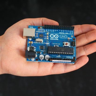

Introduction: Making an Android Application for Arduino(LED Turn ON/OFF)
here we have created an android application using ecllipse
this application turn on led on arduino.
this application also work in your LAN.

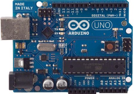

Hardware require:
1: arduino uno
2: arduino ethernet sheild
3: RJ45 cable
4: LED
5.Android Phone
Software require:
1:Ecllipse ide setting up with Android Developement Adroid SDK.
2: Arduino 2.0
Step 1 :Assigning MAc and IP to Arduino board
UPLOAD THIS PROGRAM TO ARDUINO.
ALSO CHANGE YOUR MAC AND IP ACCORDING YOUR NETWORK.
