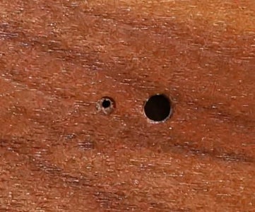

The flexible filament LEDs are just under 2mm wide but bulge at the ends. A 3mm hole is practical to allow them to easily pass through the name plate and avoid forcing sharps bends. A 1mm hole is suitable for the fishing line fixing points as the hole will be hidden by the wider filament LED on top.
The holes were marked on the wood with pencil and then a 2mm drill bit was spun slowly in reverse to mark all of the holes. The 3mm and 1mm holes were then drilled. This was practised on a scrap piece of hardwood with similar thickness first.
The layout of the holes loosely followed the template in the photograph above. The letter A was created by following the long sides of the A and then going around the back of the veneer for the A's crossbar. The intention was only to get a reasonably close rendition - more fixing points and experimentation would be required to follow a template or font precisely and there will always be limits on the bend radius.
Minimising the length of the drill bit protruding from the chuck and reseating the bit in the chuck until it can be seen to spin with minimal lateral movement (runout) will help to drill precise holes. The chuck will leave a mark if it goes too far and presses against the veneer - this is easy to do accidentally with the short, fast-penetrating 1mm drill bit.
If stripboard had been used instead of a wood veneer then the holes could have been enlarged with the 3mm drill bit.
Small drill bits are fragile and can easily break during drilling. Eye protection and spare drill bits are wise precautions.
