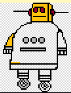

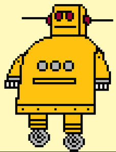

Step 1: Creating the Pattern
Using a reference photo of the Instructables Robot I created this Pixel Art Pattern.
You can see the step by step process above - I drew everything by hand.
The dimensions are 54x70 pixels which means we have 70 rows to complete.
