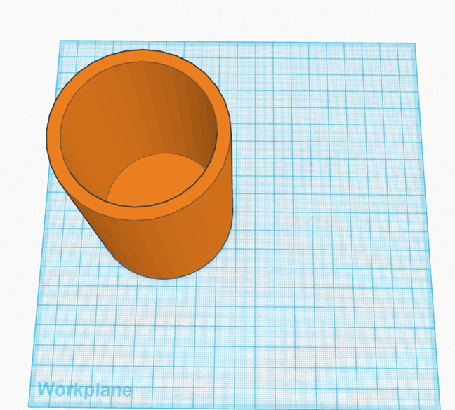

Step 3: Position the Hole to Form the Port
By placing the 2 cylinders together, we will be able to make an open cylinder.
Instructions
  1. Select the cylinder that is a hole and drag it into the solid cylinder.
  2. Align the cylinders so that they are even at the top. Since the hole is 10mm shorter, aligning both at the top will create the proper depth for the bottom of your port.
  3. Select both cylinders and click on "group" to subtract the hole from the solid cylinder.
  4. Continue to the next step.

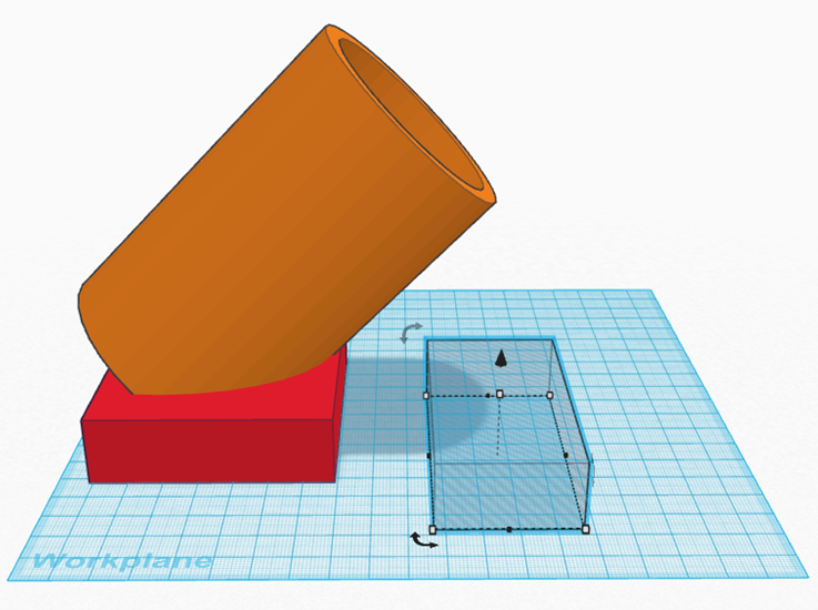

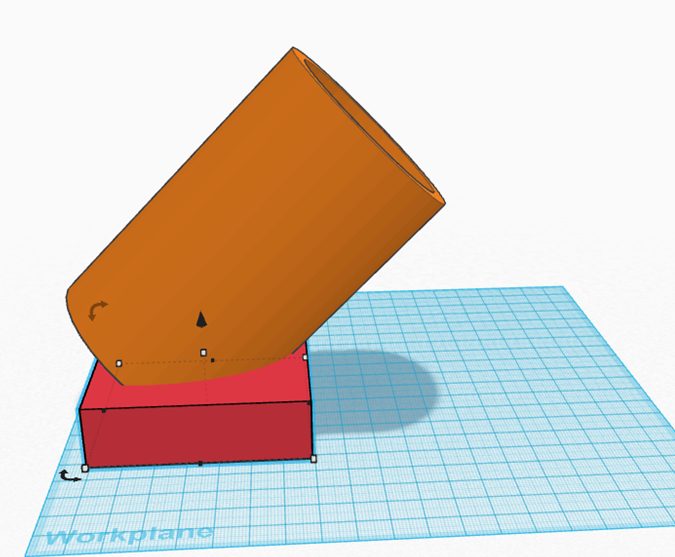

Step 5: Create the Amplifier Base
To allow the amp to stand up, we must create a base for it to rest on.
Instructions
  1. Drag a box to the workplane and size it to be 70mm by 80mm.
  2. Move the box so that the cylinder is seated solidly on it.
  3. Continue to the next step.

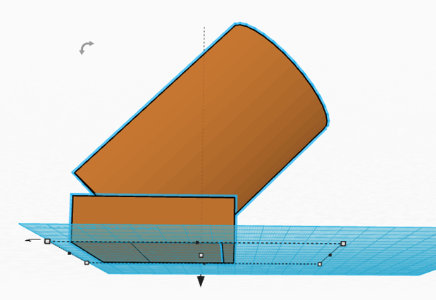

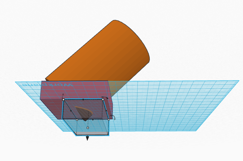

Step 6: Eliminate Unwanted Portions
When rotating your cylinder, a portion of it may have moved below the workplane. In this step, we will remove it.
Instructions
  1. Drag a box to the workplane and make it 40mm by 80mm.
  2. Turn the box into a hole.
  3. Slide the box below the workplane to cover the piece of cylinder that is projecting below the plane.
  4. Select all components and click "group" to subtract the piece below the plane.
