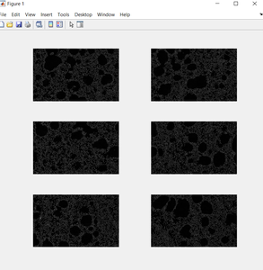

Step 3: Sectioning Image Into 24ths
First, we sectioned the image into sixths. We did this by using imagesc and grid on to find the most accurate place to split it. Each sixth was then saved as a region (the first line of code below). We plotted the six regions next to each other by repeating this entire code below six times. RegionA and so on were then split into 24ths in the same way as above. Each twenty fourth was named, in increasing pattern, Region 1 to Region 24. We saved each as a jpeg. We used the function fullfile to build a file out of the jpegs and sent the images to the file we wanted them to be located, CellSaved. We used imwrite to write the images to the file specified by fullFileName.
RegionA=bw2(1:735,800:2000);
figure(1); %opens a blank figure that all the subplot will be plotted on
subplot(3,2,1)
imshow(RegionA);
Region1=RegionA(1:368,1:600);
baseFileName = 'Region1 .jpg';
fullFileName = fullfile('C:\Users\rache\OneDrive\Documents\MATLAB\CellSaved', baseFileName);
imwrite(Region1, fullFileName);

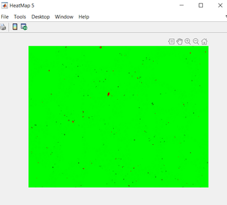

Step 4: Applying a Heatmap and Saving New Image
In this portion of the code, we applied a heatmap colormap to all of the regions. This made them be displayed in green and red. The red being the infected cells and the green being everything else. In order to later pull out the color from the image, we saved the heatmap as a jpeg.
D = 'C:\Users\rache\OneDrive\Documents\MATLAB\CellSaved';
Getdir= dir(fullfile(D,'Region*.jpg'));
for i = 1:numel(GetDir)
F = fullfile(D,Getdir(i).name);
I = imread(F);
HP1=HeatMap(I);
h=figure;
HP1=HeatMap(I);
hFig=plot(HP1);
saveas(hFig,sprintf('FIG%d.jpeg',i))
end
