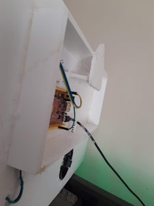

Step 5: Hot Glue It Together and Make Box
Pass the wires through to the rear of the sign. Hot glue the Mercedes sign (with LEDs already stuck on) to the base board wall.
Create a box of foam board on the rear of the base board. This will hold wires and Arduino. It will also lift the sign away from the wall (if you decide to hang it on a wall). Use hot glue and 3cm wide strips of foam board to make the box.Mark which colour wire does what in pen on the rear of the board.
Make a hanging tag out of foam board. Hot glue it in place. Make a hole in the tag and optionally use hot glue to strengthen the tag (mine hangs on a nail).
I planned to insert a spare hub cap onto the base board, so I cut a hole to place the hub cap.

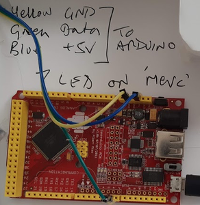

Step 6: Program and Fit Arduino Into the Box
Use the Arduino IDE to program the LEDs. I chose to have an LED start-up sequence and a change to a golden colour.
When happy with the LED colours / sequence, Hot glue the Arduino into the rear box and wire the 5 volt, GND and data wires to the Arduino.
I terminated my wires with pins and then hot glued them into place.
The USB lead to the Arduino needs to exit where the power supply will be. Use the scalpel to cut a hole in the wall of the back on the back of the sign.
