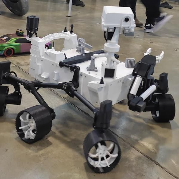

Rovers are planetary surface exploration robots that space agencies like NASA send to Mars to explore the planet. In this project, a functional 3D printed replica of the "Perseverance" rover, which was launched by NASA in July 2020, is created.
Objective
The project is named OpenRover. The main objective of OpenRover is to develop an open-source robotic platform that can enable anyone who tries building it to learn more about both the software and hardware aspects of DIY robotic projects, specially learning about widely used development boards like Arduino, ESP32 and Raspberry Pi.
As rovers are extremely sophisticated machines, they provide the perfect excuse to incorporate into the robotic platform several complex functionalities that replicate, at a smaller scale, the functionalities that real Mars rovers have (e.g., robotic arm, environmental sensors, 6-wheel drive).
Key contributions
Although many open-source robotic projects already exist, even some also related to Mars rover robots, they usually only use a single type of development board. In the OpenRover project, several development boards are used among its main functional modules (e.g., RaspberryPi for web connectivity, ESP32 for embedded screen, Arduino for motor control) and there are interactions between these modules.
This adds more educational value to the project, allowing to see each development board optimal usecase, and differentiates the OpenRover from other open-source DIY robotic projects.

  1. 6-wheel drive platform with 4 steerable wheels
  2. 4-axis foldable robotic arm with gripper
  3. Tiltable and rotary head, with space for a development board and a camera
  4. Environmental sensors to measure temperature, humidity, pressure and altitude
  5. Custom remote control module with touchscreen, with a UI where status values are displayed and different operation modes can be selected
  6. Battery sensors for the rover and the custom remote control
  7. 4 main operation modes: conventional driving control, 360º turn control, robotic arm control, head control
  8. Web dashboard that displays status values and a video feed. This web dashboard is hosted in the rover

The OpenRover's components are organized, both at a hardware and software level, in different modules:
  1. Central rover module: It has an Arduino Mega development board that is inside the main body of the rover and that manages all moving elements (e.g., motors, servomotors) as well as the rover's sensors and sending/receiving the radio signal
  2. Remote control and touchscreen module: It has an ESP32S3 development board that is responsible for the touchscreen, and an Arduino Nano that is responsible for reading the RC channel values, sending/receiving the radio signal and measuring battery levels
  3. Camera and webserver module: It has a RaspberryPi Zero 2W development board that is inside the head of the rover. This board connects to a camera, generates a WiFi network and hosts a web dashboard
