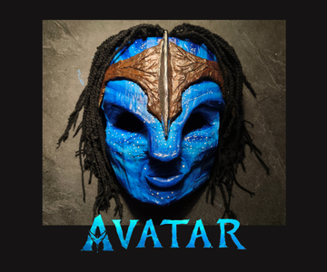

Introduction: Mask of Avatar | Face Sized & Sculpted With Foil and Paper
Pandora is honestly the coolest world out there so magical, so alive, and something I’d love to step into. And of course, what better way to enter than with a Neytiri mask? So I decided to make one for myself! And here it is.

Step 7: Bringing It All Together
Here all the pieces finally came together and everything was done. I decided not to attach the headpiece to the mask because I liked how it looked both with and without it.
Hopefully, wearing this mask gets me entry into Pandora!
