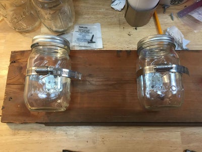

To secure my mason jars, I used metal clamps and mending plates. The mending plates secure the clamps to the board.
First, I marked the center, where the mending plate would be placed. I marked where each plate would drilled into the board using a sharpie. Then I drilled the bottom screw about 3/4 of the way into the board and slid the clamp underneath. Then I drilled the top screw in to secure the clamp. I repeated this until I had secured all of my clamps to the board.
Step 3: Finished Board
Here you can see the clamps and plates screwed into the board.
Step 4: Install Mason Jars
Using the clamps, I attached my mason jars to the piece of wood.
