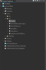

Step 5: Open Main.c File
GOTO Project and find main.c file

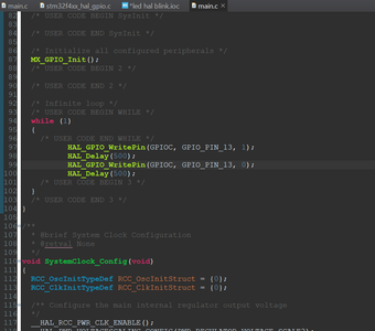

Step 6: Goto While(1) in Main() and Add Your Code
I use GPIO Pin 13 you may use other GPIO Pins
HAL_GPIO_WritePin(GPIOC, GPIO_PIN_13, 1);
HAL_Delay(500);
HAL_GPIO_WritePin(GPIOC, GPIO_PIN_13, 0);
HAL_Delay(500);

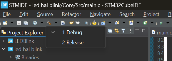

Step 7: Debug
Open and Click On Debug(1)

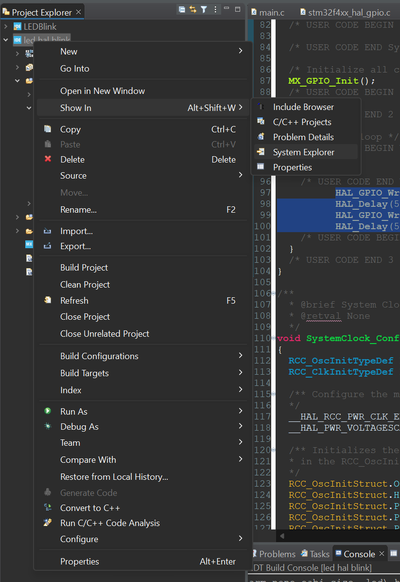

Step 8: Copy Path of .elf File Generated
Right click on Project and click on show in system explorer and copy the path.

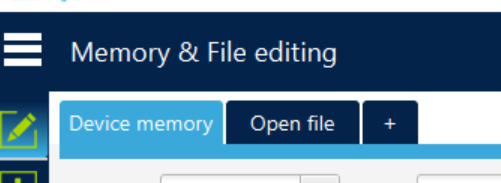

Step 9: Open STMCubeProgrammer and Connect to STM Board Via USB
Step 10: Click on Open File and Paste the Copied Path
