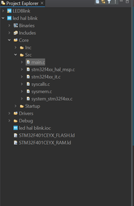

Step 5: Open Main.c File
GOTO Project and find main.c file

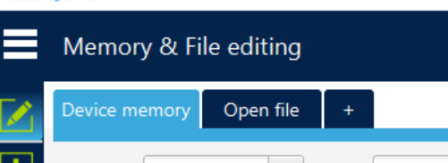

Step 9: Open STMCubeProgrammer and Connect to STM Board Via USB
Step 10: Click on Open File and Paste the Copied Path
Step 11: Go to Download Options (Found in Toolbar on the Left)
Step 12: Change Download Options and Click on "Start Automatic Mode"
