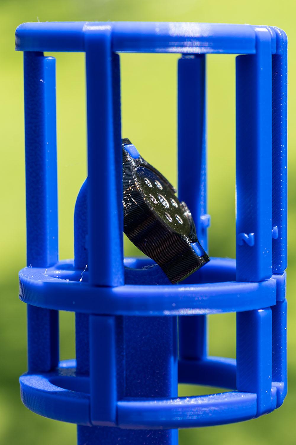

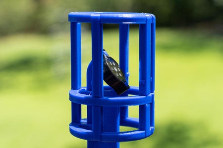

Step 6: Wind Protection
If you are planning on doing any kind of nature recording, you will need wind protection. I tried a couple DIY options for this. What I ended up with is 8 small furry “dead cats”. They can be purchased on AliExpress for less than $4 each. They are originally designed for an AT2020 microphone. I designed a frame that fits onto the ORTF Arms while centering the capsule in the airspace. They work really well although I would not use them in gale force winds.
There are two versions of print files for this. One requires supports while printing and I felt it was a pain to remove them so I designed a second version that prints flat but has to be assembled and glues. That takes less time than the support removal in my opinion. I am including both here.
Self contained: These take the longest to print and are the only ones that need support while printing. I printed them in sets of four.
Flat version:
The wind protection is made from 8 3D printed frames. Then “dead cat” furry wind screens are slid over the frames. The frames are printed as shown below and then assembled with some E6000 glue at the joints. There are three rings:
- Bottom “B” (The B faces down when assembled)
- Middle with “M” printed on it
- A top with no labelOnce the eight frames are assembled, they snug onto the ORTF arms as shown. Use some E6000 glue on the edge of the joint to lock it in place. After the glue dries, you can slip on the actual furry windscreen.
There will be a bit of a gap at the bottom of the furry section. You can tighten it with a rubber band or hair band.
