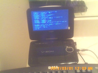

Dvd player as a computer monitor? You remember that we used a composite monitor back in the Mythtv instructables. (https://www.instructables.com/id/Setting-up-a-computer-based-DVR-with-Mythtv-for-l/). Here we are going to do a variation on that but use a dvd player as the monitor. Though I meant this to be for text based server and computers Certain low gui desktops could work also.
Most but not all computer servers are going to the command line I.e no graphics. Even as I understand it, MSWindows 8 server is going to the command line. Never hurts to have a back up monitor for an emergency, for portability, or if you just want to go retro.

Update: Using the dvd player as a monitor for Raspbmc!

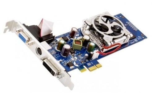

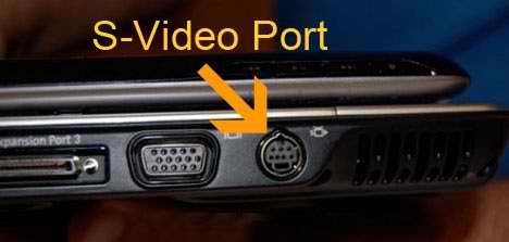

Step 1: Computer Video Output.

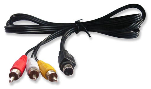

Step 2: Adapter Cables and Adapters.

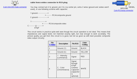

Step 3: Make Your Own Adapter.

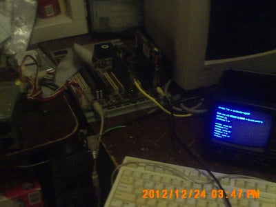

Step 5: The Computer.
Note: You do not need that many cables. We were just testing quite a lot of things to see what worked.
Step 6: Graphics.

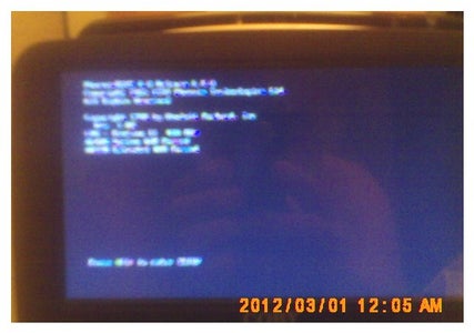

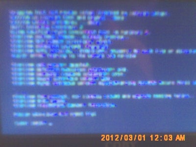

Step 8: Test Hack.

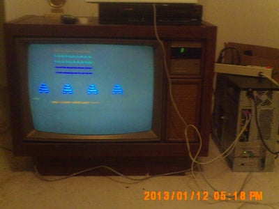

Step 9: The TV the Media Said Was Worthless.

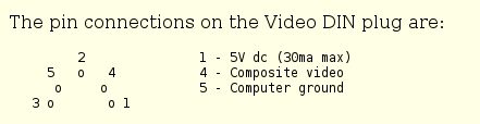

Almost had forgotten about this At one time I had a Commodore computer or two and needed another monitor, but did not want to spend several hundred dollars for another monitor. This was probably one of my first hardware hacks. The Trs-80 model one monitor was basically a composite monitor but required a +5 v dc line.
Model 1 video connector
The TRS-80 Model 1 monitor was actually a black and white RCA television set with most of the guts taken out. Because the chassis was connected to the power mains, Radio Shack added an optical isolator to help prevent shocks. The output of the TRS-80 was 5 volts to power the optoisolator, and a standard 2 volt composite video signal. If you want to have a bigger monitor, you can wire up a DIN connector with pins 4 and 5 and connect that to the video input of your TV (or VCR or whatever).
