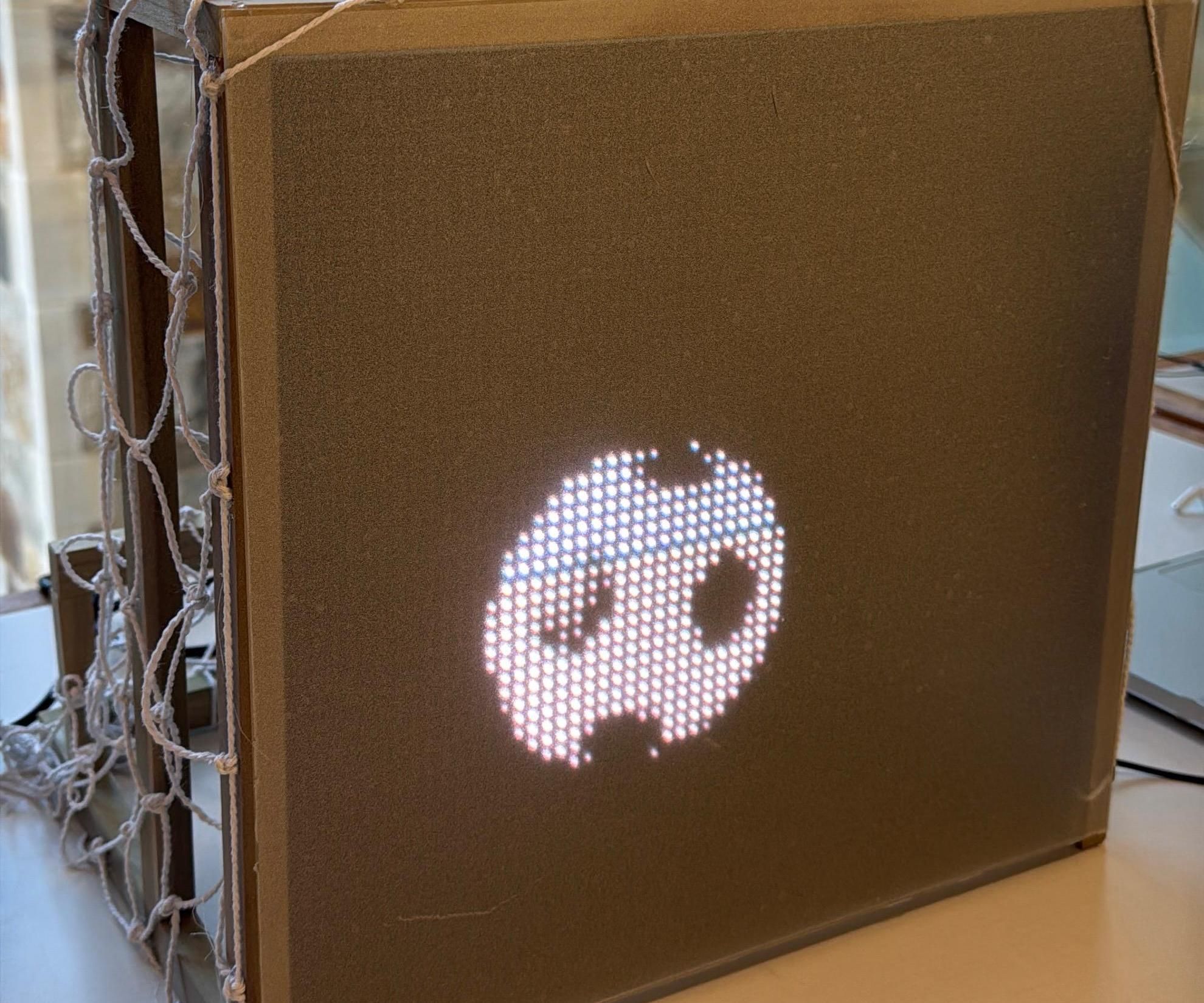

Step 1: Build the Structure
Build the structure using the materials above. Machines used for materials below:
Wood machines (band saw, table saw, sander): Structure
Laser Cutter: some wood piece, acrylic pieces
3D printer: Buttons
Pixel blazes were taped together and attached.

Step 5: Connect to Pixel Blaze to Create Pattern List for 16x16
This is the playlist of patterns for the 4 16x16 PixelBlazes. The mapper was not used. The patterns bypass the mapper. These patterns were premade patterns that we downloaded and placed into playlist.
Attached are the GitHub of some of the downloaded patterns. Other patterns were found on the start page of the Pixelblaze. Create your favorite playlist of patterns!
