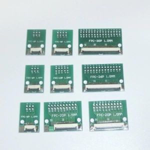

1PCS DIY FPC/FFC Adapter Board 1.0mm Connector 4P $2,-

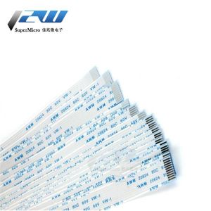

Flat flexible cable FFC FPC LCD cable AWM 20624 80C 60V VW-1 FFC-1.0MM $3,-

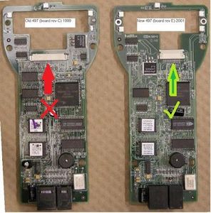

Step 1: Check If This Instructable Is Compatible Your Autostar Handset
before you carry on to the next step check the picture if your handset is compatible with this instructable there are 2 models from before 2001 and after.

FPC/FFC Adapter Board 1.0mm (to connect the flatcable to the lcd)
14P Flat flexible cable FFC FPC 1.0mm (flatcable to connect to the FPC/FFC and the Meade Autostar handset)

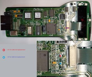

Okay now connecting things is pretty straight forward you have to solder 14 wires between the fpc adapter board and the display(see images), solder wire 2 to 3, and wire 3 to 2, all other wires go to the corresponding number for example 1 on 1, 4 on 4, 5 on 5 etc.
The display itself also needs power on pin 15 and 16 you can get that from the autostar 497 mainboard and make sure you run the cable through the hole! (See images)
check that you wired everything correctly and do a test before you proceed it should light up and display text.
(to make placing the display easier solder the wires on the backside of the display under a angle)

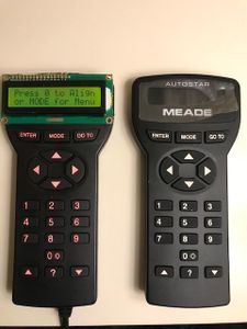

Step 6: All Done!
Nice all done!
(in the settings you can adjust contrast of the display)
