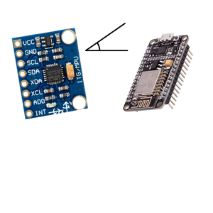

Introduction: Measure Angles Easily With MPU6050 and ESP32: Part 1 - Library Walkthrough
About: Keep improving every day, and help others improve too.
Using the MPU6050 to find angles can be a tricky business, requiring sophisticated forms of sensor fusion and offset calculation. Many tutorials online demonstrate how to calculate the angle with simple sets of formulas, which frustratingly do not work in practice, as you may have found out. There is a convenient library i2cdevlib that utilizes sensor fusion and does the heavy work for us to give us accurate orientation values in both static and dynamic sensor applications. We will walk through how to set that up in this tutorial using PlatformIO IDE extension in VSCode with the Arduino framework. By the end of it, you will have code that provides accurate sensor values without needing to understand the complicated theory of sensor fusion algorithms.

Step 1: Setup Physical Connection
Set up your connection as shown in the diagram with 4 jumper wires. You can buy the ESP32 and the MPU6050 with the links below; they come pre-soldered which allows you to save time and money.
