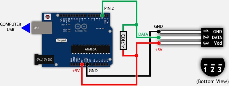

Step 1: Arduino+Temperature Sensor Wiring
Follow the photo (sketch) for wiring your Arduino Ethernet with the temperature sensor. The sketch was prepared by Hens. You can see the other two photos are for my breadboard during the test and my arduino ethernet board.

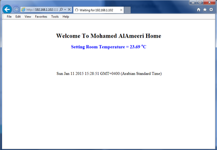

Go to your web explorer and write your IP address with the port number you assigned for access your arduino webserver. For example: http://192.168.1.102:111
And you are done.
