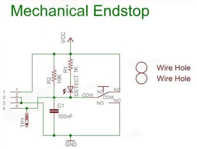

Step 2: PCB Board and Schematic Diagram
Design printed circuit board (PCB), I was used ,,Sprint-Layout" software.
