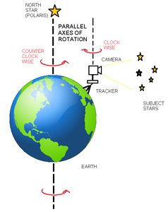

The idea is simply to rotate the camera at the same rate that the earth rotates, but in the opposite direction. However, this axis of rotation must be aligned with the same axis of rotation of the earth for the effect to take place.

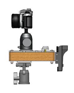

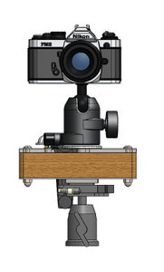

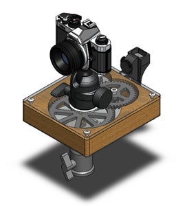

The design is fairly simple. The timer has a gear connected to the shaft, and connects to a 24:1 gear train, with the shaft of the final gear being connected to a tripod ball-head. The camera then attaches and can be aimed in any direction (the direction you photograph is independent of the rotational axis). A red dot sight is used to align with the north star out in the field. To set the RDS, a laser is attached to the shaft of the final gear and the two are aimed at a wall, and the sight is adjusted until it overlaps the laser dot.

The attached DWG can be used to laser cut the gears, if you wish.
The Nikon model I used is by Joel Anderson
https://grabcad.com/library/nikon-fm2-slash-n-film...
The ball head is by Bob Jenney
https://grabcad.com/library/manfrotto-488rc2-ball-...
Can't find the lower tripod head model anymore. The rest was done by me.

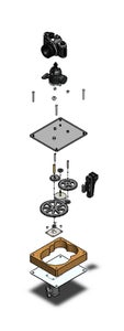

The timer was removed from its plastic housing, and I found it had a convenient 1/4" shaft on it, which was easy to mount a gear on. The knob was kept to allow me to wind up the timer easily.
The gears are laser cut from acrylic, as is the top of the tracker. If you don't have access to a laser cutter or don't want to spend the money to have it cut by a laser cutting service, there are other Instructables on how to make wooden gears from plywood using a saw. You can definitely recreate these gears using this method. The gears were designed from the Solidworks Toolbox and altered slightly for my use.
The gears are held on shafts which have a flat side, and a point at one end used as a simple pin bearing. The idea is to minimize friction by having a very small surface area where the weight is. This proved to be insufficient for the large gear, so a spring and a bearing were added beneath it to hold it in place firmly, while still minimizing friction. The top of each gear shaft is held in a small nylon bushing which is machined to press into the acrylic top, keeping it in place.
The wooden portion of the housing is just two pieces of 1.5" thick poplar board from the local hardware store. I bolted the two pieces together while working on them, then glued it afterwards, because hole saws can't cut through that thickness so I needed to be able to separate the two pieces during the cutting.
The bottom is 18 gauge steel plate, cut to match the rest and align with the four bolts that hold the whole thing together. On the very bottom is a 0.5" thick aluminum block machined with a 1/4-20 hole where the tripod mounts to.
The alignment laser is mounted inside a little threaded holder that goes onto the end of the shaft where the ball head normally mounts. I use this to align the RDS correctly, then remove it and install the ball head. A simple version of this would be to cut some extruded aluminum to make an X-block that the laser could be strapped right to the side of the ball head, if the ball head has a good concentric face on it. Mine does so I will be using this method in the future to align, as it is easier and probably more accurate.
Step 3: Assembly

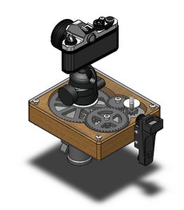

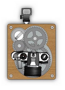

Since the timer is mechanically a very weak mechanism, designed only to have to rotate the knob back to the starting position, it doesn't have the strength to move the camera. Instead, a spring is hooked to the main gear and mounted to the top cover which pulls the gear in a clockwise direction. Now, the timer is effectively serving as an inhibitor to the spring's motion, and instead slowly allows the spring to rotate the camera in a clockwise direction. This eliminates the issue of torque in the drive system, and also keeps the gears tight to eliminate backlash. When the timer is wound up, the spring becomes increasingly stretched, and never fully slackens during use. You can see in the pictures that it is constantly stretched.
