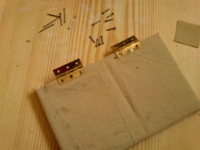

Step 5: Door
Almost last step is making some door.
Take the square stick and cut it according to the dimensions of the lantern (my door were something about 9cm X 14,5cm). Then nail the sticks together. You can use a glue as I did.
Then put the frame on the fabric. After that draw the shape for covering and cut it. Again I used glue and nail to secure it in the right place.
I also wanted some cool picture which would be seen when the candle is fired, so I painted some bird motif on the door.
Next step is to attach a door handle. I used a scrap piece of stick and a nail.
You can also add some hook and a loop as a lock, but mine door are pretty tough, so I didn't add it.
Last step is adding the hinges. First nail them on the door and after thet attach it to the lantern.

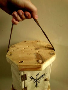

I decided to make the holding strap out of leather.
I think it doesn't require a long comment. Just take a piece of leather belt and nail it to sides of the lantern :)

Step 7: Let There Be Light!
And we got to the finish line!
So go get your candle and let there be light!
I'm not sure, how much historically acurate is this octagonal lantern (because of hinges and stuff). But I'll post the square lantern as soon as I'll get the parchment raw hide, so it should be better. But I think that for LARPing it's just fine! :)
I also had to enlarge the ventilation holes because the small ones weren't so efective when it came to the draining the hot air.
But my conclusion: I love it! And I can't wait for an opportunity to use it!
