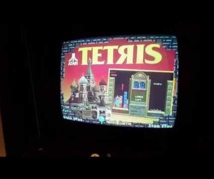

Step 4: Final Result
And this is it. I am quite satisfied with the final results and retro feeling is even more present than expected. There is only one thing I would have improved in the project: the weight of the final product. I feel the case now too light and some kind of ballast would have improved the final result. Anyway this is a minor problem that can be fixed at any time.
