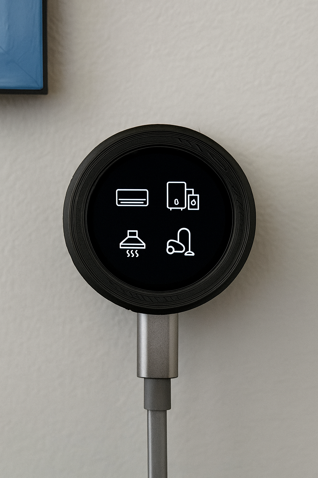

With a simple touchscreen interface, you can select the type of appliance or task you want to track. A progress bar shows you how much time is left until the next repair, filter change, or service. Thanks to a built-in battery backup, Mendly keeps working even during power outages, ensuring you never lose track of your reminders.
This project is built using a Waveshare 1.28-inch ESP32-S3 Round Touch Display, housed in a 3D-printed case designed in Tinkercad. It’s powered by a 500mAh rechargeable battery with Type-C charging, and the user interface is created with custom graphics in SquareLine Studio, rendered using the TFT_eSPI library in Arduino IDE.
Compact and easy to mount with 3M tape, Mendly quietly sits on your wall and makes sure you never forget an important maintenance task again—saving you both time and money while keeping your home running smoothly.

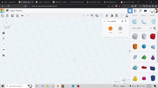

Step 1: Designing the Enclosure in Tinkercad
I wanted the enclosure to look just as sleek and modern as the round display itself. Using TinkerCAD, I designed a three-part snap-fit case—a front shell, back cover, and middle ring. Before designing, I carefully measured the dimensions of the display, battery, and USB Type-C port to ensure everything fits snugly without extra gaps. The middle section holds the display firmly, while also leaving a clean opening for the charging port. The snap-fit design means no screws are needed, making it simple to assemble, lightweight, and easy to maintain while keeping a professional finish.

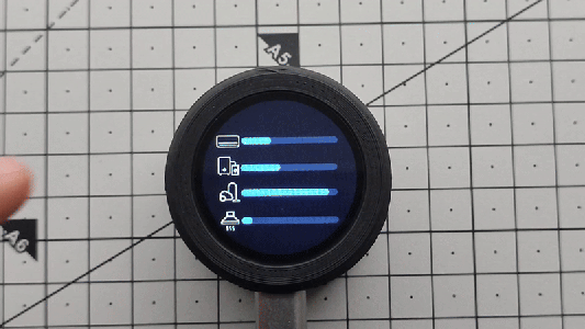

  1. Progress Bar Page – shows the remaining time until the next maintenance.
  2. Home Screen – displays all equipment (currently: Air Conditioner, Water Purifier, Vacuum, Exhaust Fan).

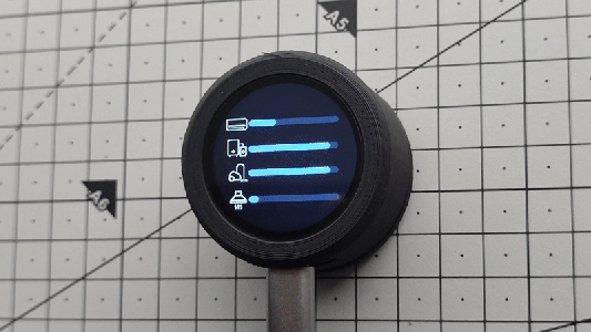

Step 7: Using the Device
  1. The home screen shows a progress bar so you can track maintenance status live.
  2. Tap the home screen to access four icons: Air Conditioner, Water Purifier, Vacuum, and Exhaust Fan.
  3. Select any icon to open a screen where you can set the alert time for that specific device.
  4. Return to the previous menu anytime by tapping anywhere on the screen outside of the buttons.
  5. After setting the time, you’ll be redirected back to the home screen.
  6. When an alert appears, simply tap “OK” to confirm you’ve acknowledged the reminder.
