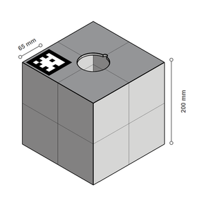

The nagakin tower modules, a cube structure with a circular cutout as a window. In our case the Unit is Cube 20 x 20 x 20 cm with a 65 mm hole cut out in the middle. Inspired by Cedric Price a unique QR code was used to not only identifying each unit but also allowing for tracking of position and rotation in space.

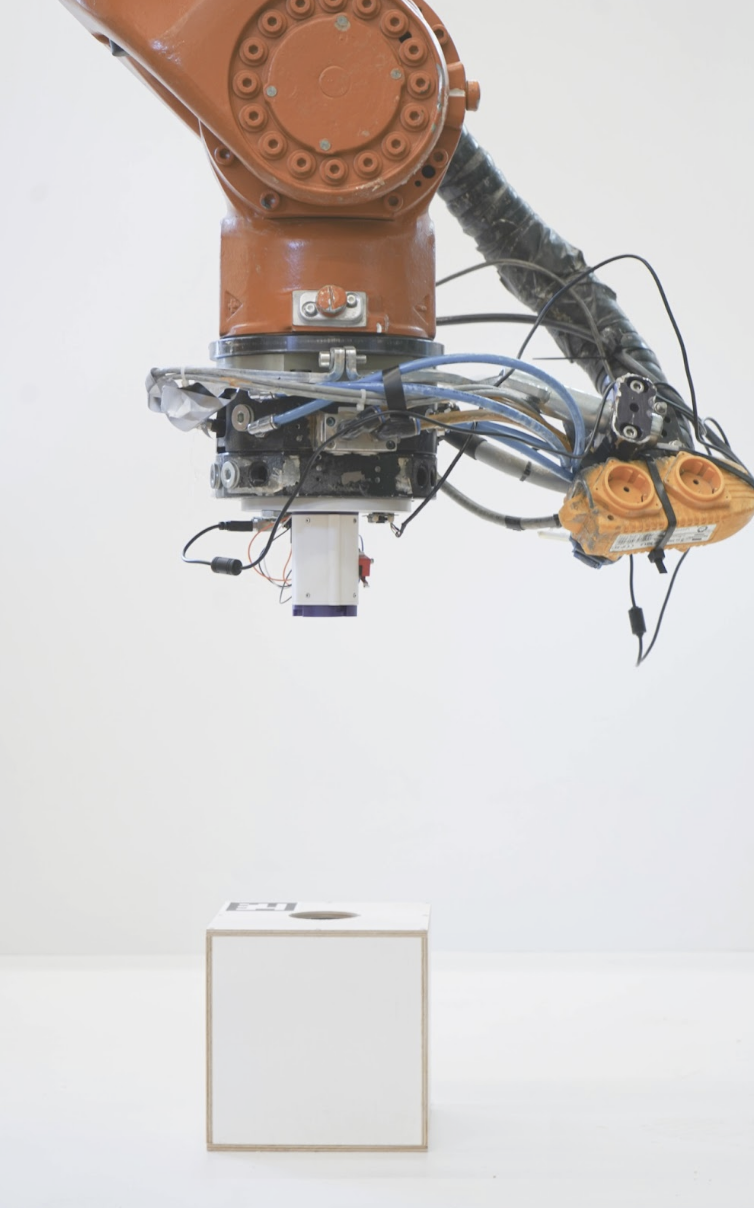

(Fig. 2) The endeffector itself consists of gripper and actuation gears mounted on a plate which connects them to the servo motor. The top plate is mounted to the connection shaft, where the end stop is also attached. Finally everthing is connected to the mountingplate which also houses the arduino and camera module.

The sequencing of our workflow (Fig. 1) starts out with the Robot in its Home position, from here we can go into the sensing pass, effectively scanning the area in a back and forth motion. Each time a Box with its QR is detected the position and rotation is being saved using a Python component. After all the Boxes have been detected we can move on into the pick and place phase. Because of their unique IDs we can start with any box, a user specific, a random or just with the first box followed by an ascending order. The robot moves over the first box and slowly down until the end stop is triggered and thus the gripper being enabled. The Box is then lifted and placed at which point the gripper can be disengaged. If there are still any boxes left we repeat this pick and place sequence until all the boxes are placed. The robot then precedes to again stop at the home position.
