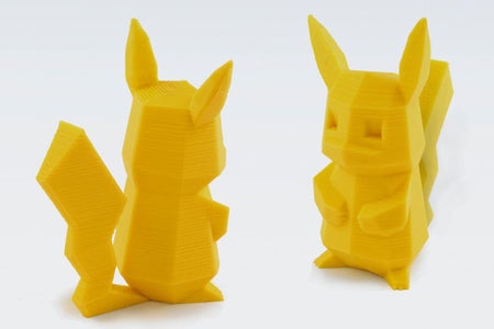

This is the first way. And it’s very simple. The only thing you need to do is instead of printing your part, you print a mold of your part in ABS. Once you have it, you melt the metal and fill the mold with it. Then wait till metal is cold and submerge the mold with the part in acetone. This will melt the mold and you will get the metallic part. Let me try to explain it better with an example. In this case we will cast a Pikachu.
Step 1: Create the Mold

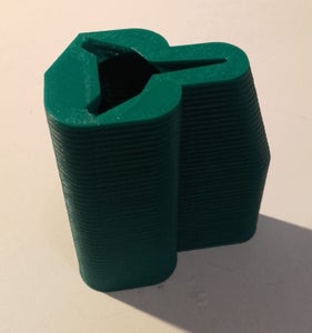

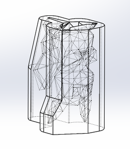

First we need to draw or download our part. But we don’t print it. What we do is drawing a cube to cover or part and we subtract the part to this cube. This will be our mold. It’s important to keep one part open so we can fill it. Another important thing is to have some place were to have extra material because when metal cools down it reduces the volume (I didn’t do it on mine …). Once we have this we print it. Resolution is a very important parameter, because otherwise we will have a lot of marks on our metallic part.

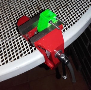

Then we need to find a way of fixing the mold while we fill it. Is important to not hold it with the hand because melt metal can be dangerous … The mold of my picture is not the same as Pikachu but you will see a way of holding the molds.

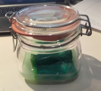

Step 5: Dissolve It in Acetone
Then get a glass recipient (something that can be closed) and fill it with acetone. What you will have to do is submerge the mold inside the acetone. That will melt the ABS away and you will get the final metallic part. This process is slow.

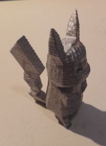

Step 6: Final Result

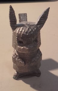

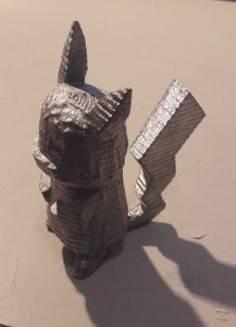

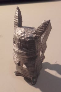

And you will have your metallic part. Easy, right?
You can see lots more of information and pictures in my web (just in Spanish …). I would also like to apologies for my English level … Here you have the pictures of mi Pikachu:

    I use SolidWorks. Is the same that I use to design my 3D printers. But
    any other soft will work. The only think you need to do is subtract a model
    (the future metal part) from a cube that will be the mold.
    I try to reduce the volume of the mold because otherwise it takes longer
    to dissolve in acetone.
