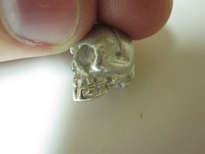

Not to long ago, I started my ventures into metal casting. My early molds were made of plaster, but I quickly learned that silicone epoxy makes GREAT metal casting molds. Unfortunately, the silicone epoxy I was using was not designed for casting metal, and was too soft and flexible. My early silicone molds were not tough enough for lots of repeated use.
But Sugru, on the other hand, is a very durable silicone mold making material. It makes molds just as good as the silicone epoxy I used previously, except Sugru is WAY more durable, and will make molds that will last dozens of casts.
The cast quality of this skull isn't quite exactly what I'm after, but I was in a hurry. Molds need to be broken in before they with make great casts, so the first, second, or even third castings may have bubbles or vacancies. The skull in the main picture is the second cast. You shoulda seen the first one ;)

Step 2: Making the Mold
Sugru is very sticky. You need it to release from the object you are molding, so oil the object in question. You'll only need a little bit of oil on the object, don't over do it and make it all drippy.
Gently mold the Sugru around the object; in this case, a small skull bead. Leave a little opening to poor the metal through (see picture two)
Put the new mold on a flat surface and let the it dry for 24 hours.

In my experience with casting metal in silicone, molds need to be broken in. Your first few casts will probably be failures, but the more you cast the better the mold gets.
Casting is pretty straightforward: Melt the solder with the butane torch in a crucible of some kind, and poor the molten metal into your mold.
After the metal is cool, you can unclamp and pull the cast of of the mold
Step 5: Results
Now I did this because I wanted to show you that metal casting in Sugru CAN be done. If I spent more time use the mold, then my results would have been even more accurate.
Take a look at the Buddha on the intro. I Cast that using this same method. The mold I used was just more used and very well broken in.
