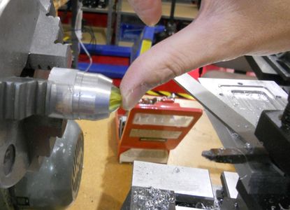

Step 5: Using a Lathe
Using a lathe is fairly straight forward: you clamp an object in a chuck; the chuck spins; a tool is brought up to the spinning object and material is cut/scraped away. There are a lot of online instructions to explain it all. Here are a few links. If planning on purchasing a lathe, read these.
http://www.sherline.com/latheins.htm (I like Sherline and wish I had the money to buy one).
http://team358.org/files/mechanical/HowToUseALathe.pdf
http://www.americanmachinetools.com/how_to_use_a_lathe.htm
On this step I will show through the images how I chucked a piece, centered it on the chuck, then made the cuts. The longest process is the setup, which involves making sure the piece is centered and balanced, choosing the correct cutting tool, and making sure the cutting tool is the correct height. Choosing the right tool and setting the tool height is covered in a lot of tutorials and is often about user preference. But centering the piece to be cut is not open to interpretation. The piece is either centered and the end result looks good, or the piece is off center the the end product is ugly.
As part of the setup, I realized my cutters were to large to make the hole for the glass marble and I had to make a cutting tool (boring bar). I will provide links to show you how that is done too.

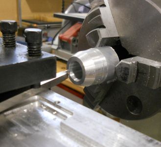

First piece to shape is the emitter head. I chucked a piece of 1 inch round rod. I tightened the chuck just enough to hold the piece firmly in place but not tight enough to actually start turning (cutting) it. To help visualize how to center and balance it, i colored stock red and the other side blue. I attached my dial indicator to the magnetic base and put that on the slide. I put the tip of the dial indicator probe a 1/4 inch from the tip of the piece on the chuck. I started turning the chuck by hand slowly and watched the dial indicator needle swing wildly across the dial face. I made a mental note of the highest value and the lowest value. I then rotated the chuck so that the dial needle was at its highest value. I then took a large allen wrench and tapped the top of the work piece as I watched the dial needle move to a lower value with each tap. I was trying to bring the dial needle to the middle of the highest value and the lowest value. Once I have it close (about 3-5 thousands of an inch) I rotated the chuck by hand again, making a mental note of the highest value and lowest value again. the second time rotating the chuck by hand the dial indicator was not moving as much. Again, I rotate the piece to the highest value on the dial indicator and tap the top of the workpiece to move the dial needle between the highest value and lowest value. Rotate by hand again and the needle should now either stay steady or only move one thousands of an inch. Tighten the chuck completely. This whole process used to take me anywhere from 10 to 15 minutes because i learned on my own and no one explained it to me. Now I can center an object in a chuck in about 2 minutes. Remove the dial indicator.
The piece is now centered and is ready to be turned.
I rotated my tool holder to the 20 degree position and turned the top of the emitter. I then rotated the tool holder to zero degrees and made my other cut. I attached a drill chuck to the tail stock and put a 1/2 inch drill bit on. Using plenty of WD40, i bore a hole through the center of the emitter. Cutting oil or tapping oil works too.
The cutting tools I have are 1/2" cutters. they are way too big to fit inside the center hole. But I needed to make the hole bigger to make the marble fit. What I did was get a 1/8" square HSS tool blank and shaped it into a boring bar. I followed these two instructions.
http://www.sherline.com/grinding.htm
http://littlemachineshop.com/instructions/GrindingToolBits.pdf
It is a lot easier than it looks. Just make sure to have a cup of water nearby and cool the tool blank frequently.
Once the hole for the marble was done, i removed the piece from the chuck, rotated it end over end 180 degrees, and re-chucked it. I did the setup process again and turned the piece to its final shape.
The neck, inner sleeve, and main body followed the exact same process above. once all the pieces were turned. I did a crude test fit.
I hope everyone enjoys the pictures.

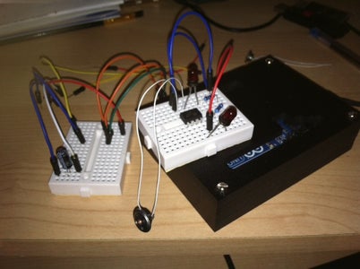

Step 9: Arduino Sketch
I followed these directions to use Arduino on an ATTiny85:
http://hlt.media.mit.edu/?p=1695
Attached is the Arduino sketch I used to make the sound and lights. Feel free to modify the sketch so you get the pitch and modulation you want as well as the blink pattern you want. In the sketch I used two(2) output pins to control two LEDs.
I used an Arduino Uno to program the ATTiny85. Please follow the links above to find out how to program an ATTiny85 as an Arduino microcontroller.
I set up two breadboards. one breadboard is to program the chip. the other breadboard is to test the program.
The code build on the example code -
created 21 Jan 2010, modified 30 Aug 2011, by Tom Igoe
(I give credit where credit is due. If using my code, please do the same)
Here is the TONE TUTORIAL in Arduino
the sketch looks like this:

Attached is the circuit board I made to hold the ATTiny85.
The file was made on CamBam. My PCBs where mechanically etched using an CNC router. Chemical etching would probably be easier.
Also attached is RAR file called "EagleFilesAndSchematics" which has the Eagle files and as well as the PDF for a two layer board layout ( BOARD2.pdf) and the schematics ( SCH2.pdf) pictured above.
Please download those if you are used to using Eagle for electronics design.
I had an electrical engineer with decades of experience look over my design and confirm it is sound. He designed the schematics for me on Eagle. He did make a change to my design in that the schematic has the switch attached to the POSITIVE terminal of the battery to complete the circuit to 8th leg of the ATTiny85 (VCC). Also his PCB design is double-sided. Both PCBs are 0.5 inch by 1.5 inch.
The PCB can be made to fit inside the inner sleeve. If the PCB design is too large, let me know and I can shrink it down some more. The only limitation is the size of the ATTiny85 itself.
Here is the Datasheet for the ATTiny85:
http://www.atmel.com/Images/Atmel-2586-AVR-8-bit-Microcontroller-ATtiny25-ATtiny45-ATtiny85_Datasheet.pdf
Please pay a lot of attention to the ATTiny85 datasheet "Pinout" diagram. The physical legs are NOT corresponding to the pinout numbers. That is PIN 2 is NOT LEG 2 on the DIP chip. The pinout mapping is as follows:
PIN1 = leg6
PIN2 = leg7
PIN3 = leg2
PIN4 = leg3
Leg 4 is GROUND
Leg 8 is VCC (positive to battery)
Here is a video of me making a PCB mechanically:
The PCB etching is mirrored because the chip and most of the components will be on the back side of the PCB. This is why the "1" is backwards.
