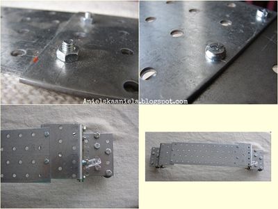

Step 3: How to Make Metal Loom?
First connect 2 metal brackets with each other next connect them with metal plate with the help of little screws and nuts. (first photo)
Install 6 long screws , add metal washer with rubber and buterfly shape nuts (second photo)

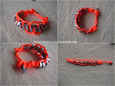

Step 7: How to Make Bracelet With the Help of Metal Loom ?
You need:
metal nuts
twine or anything you like
Step 8: All Easy Steps
Measure your wrist and cut right lenght of twine.
Create clasp to bracelet.
Slip metal nuts on twines and pin on twines to loom.
Weave according to the instruction on photos. (4th photo)
Weave more using macrame knot or according to the instruction on photos.

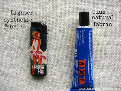

Step 9: How to Protect the Ends From Unraveling?
Protect the ends of synthetic twines or ribbons with the help of lighter.
In case of natural fabric use glue.
Step 10: Ready Bracelet
Voila! the bracelet is ready :-)
