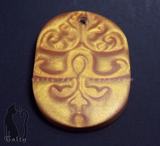

Step 9: Sanding
To bring out the mica shift effect, you will need to sand the polymer clay. Some colors don't even show the mica shift until you sand them, so don't skip this step. I know that sanding polymer clay can be tedious, but it's worth it. If you have a dremel, use it.
I use wet/dry sandpaper, start from the coarser grit to get rid of all the remaining raised parts of the impression. Make sure the clay is perfectly flat before you proceed. Then build your way up to remove all the scratches and make the clay smooth. Don't sand the clay dry, you risk breathing the dust and I'm quite sure it's not healthy.
This is the list of grits I use:
320 - Coarser. After sanding the polymer clay will look opaque and the mica shift effect will be less noticeable. Don't despair, that's normal.
600
1000 - You can stop here if you want, and the clay will look fine.
1500
2000 - Softer. Going all the way to 2000 makes the clay really smooth and shiny. I love touching clay that is sanded with a 2000 grit, it's very smooth and soft.

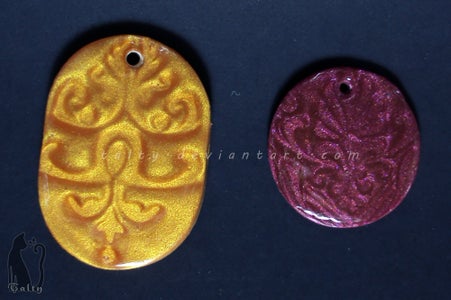

If you haven't tried buffing polymer clay before, you are going to love it. I was so surprised the first time I did it, and it's the perfect finish for the mica shift effect. Buffing polymer clay makes it look shinier, and the mica shift effect will be even bolder.
I use and old denim skirt to buff the clay, but you can also use one of those buffing files for nails. I've read that you can't use buffing paste (something about ruining the clay), but I haven't tried it yet. Make sure your clay is dry and start rubbing the denim or file against the polymer clay, I do it in small circles for no particular reason. It only takes 2 or 3 minutes of buffing and it's ready!
If you use denim, make sure to use a light colored or "raw" colored piece of denim. Darker colors can stain polymer clay (learn from my mistakes, don't do it). If it happens, sand your clay again to remove the top stained surface.
Step 11: Finished!
Admire your little creation, pat yourself in the back. You can't really understand how amazing this effect looks until you see it in person, the photos don't do any justice to the beautiful optical effect this is. Practice, each pendant I make looks better and better!
