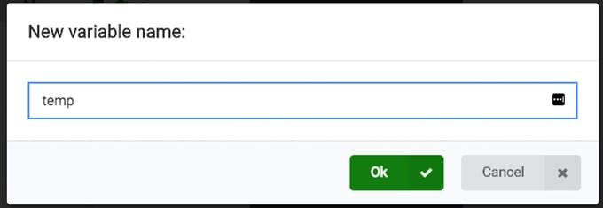

The first thing we have to do is make a variable for the temperature value. A variable is basically a container that holds information. You can see the options for different kinds of blocks in the side panel:
Click on "variable" and choose "make a variable". It’s best to label the variable with short but descriptive names. We’ll call our variable "temp", short for temperature. Click "OK". Now if we go back to our variable menu, our variable will show up there.
It’s best to label them with short but descriptive names. We’ll call our variable 'temp,' short for temperature. The temp variable will constantly update with data from our temperature sensor.

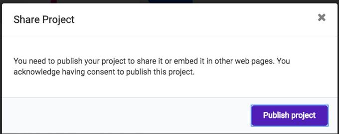

You can also share your code by clicking “share”. This creates a link to a page where your code exists online. You can share this link with others if you’d like to share your code.
