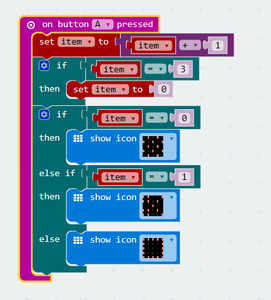

Set the function of button “A”. Every press changes pattern order. We use pattern "X" to show rock, pattern "k" to show scissors, and pattern "口“ for paper.
