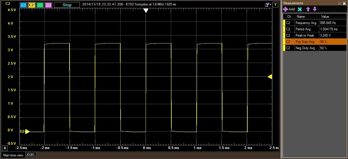

Below you'll find o-scope images of the output, first from the chipKIT Uno32...
...and then from the Arduino UNO.
Crazy enough, these images were generated using the register manipulation sketch as shown above, and when I tested the standard function sketch, the exact same image popped up. Weird, right? So I figured I would spare you having to waste time looking at a duplicate. I also have no idea why the Arduino UNO is quite unstable at peak output, so if anybody has any legitimate explanation, please clarify in the comments.
