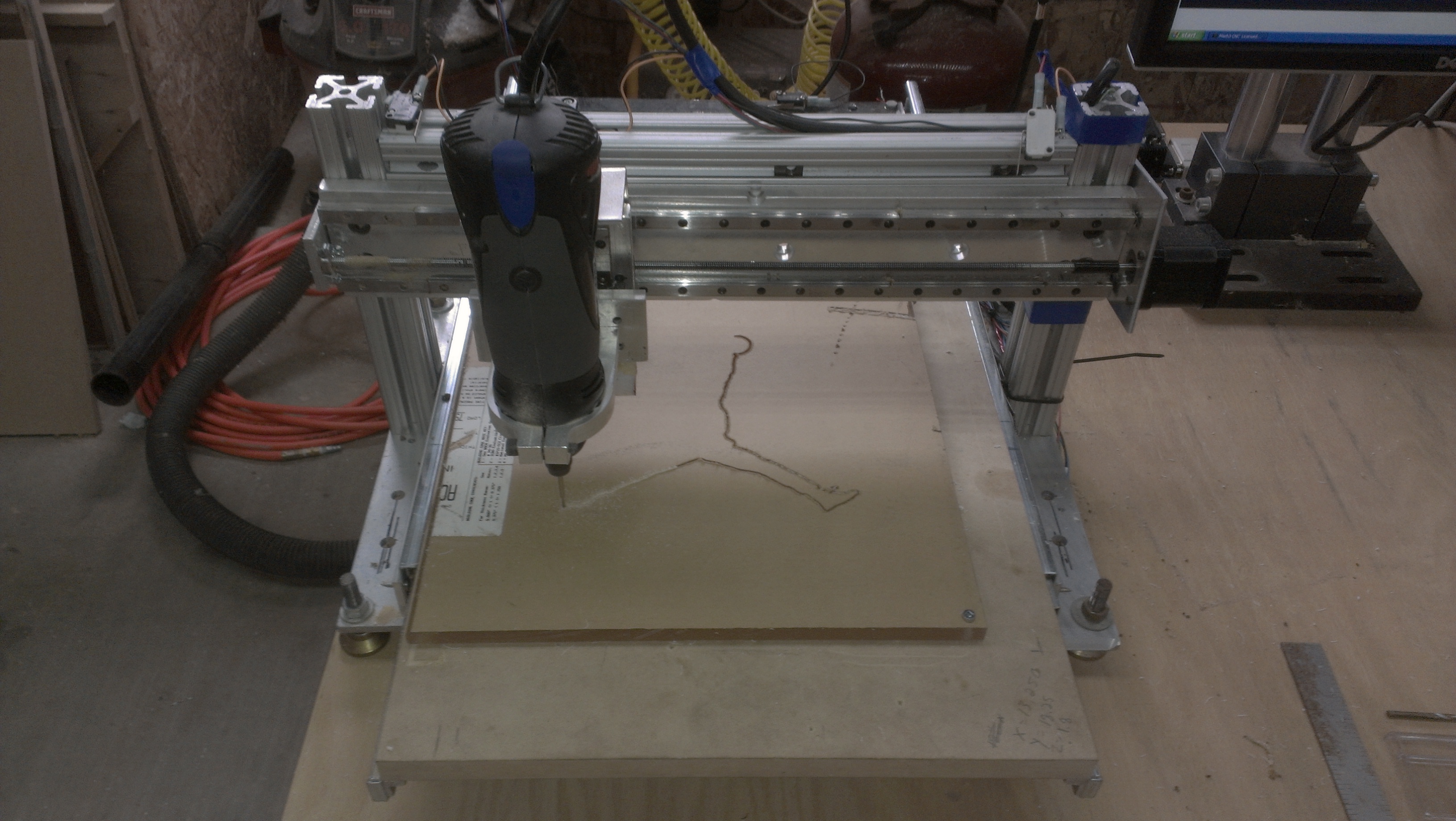

This piece was made to show the career of a soldier in the South Dakota Army National Guard with his collection of challenge coins. I used a homemade CNC machine and Mach3 software to mill out the holes for the coins. I also used a Epilog laser and CorelDraw6, at my school, to etch the images on the acrylic, I love how much fun you can have with lasers:) This is a very proud and noble tradition in the military. These coins are given to soldiers for exemplary service and work. My plan is to make these for veterans in my community at material cost. The best part is that both sides of the coin can be seen. I hope you like what I've come up with :) These projects are so much FUN!

Step 2: Setting Up CNC and Software
Draw in your coins to Mach3 in the arrangement that you want, make sure to add a little to your measurements so the coins will fit (I added .1in on the diameter). Once they are all drawn in set the depth, tool size, and speed.
Secure the veneer in the CNC and set your zero point. Double check that the depth, tool size, and speed is set correctly (took me a "practice piece" to get it right).
Run your program and watch it go:)

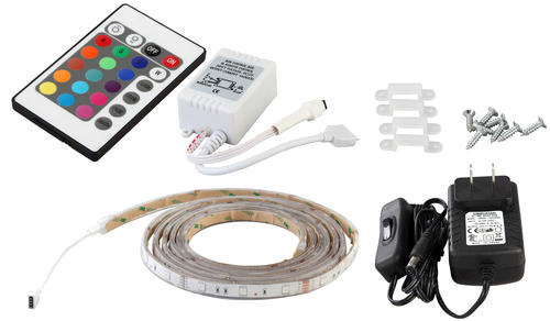

Step 7: LED's
I used Patriot RGB tape LED's and stuck them to the inside of the routed part of the frame. Now, you could easily use through hole LED's and solder them together and then place them in the frame. Just be sure everything will fit. I used the RGB type with remote because I like the fade feature, I figured it would look nice switching colors :)
