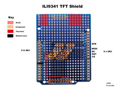

Step 2: Circuit
The circuit diagram for my EEG display is shown in photo 1.
Construction details for the matching shield (photo 2) are given in my instructable https://www.instructables.com/id/Arduino-TFT-Grap...
