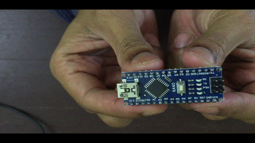

1 >> Arduino NANO or UNO.

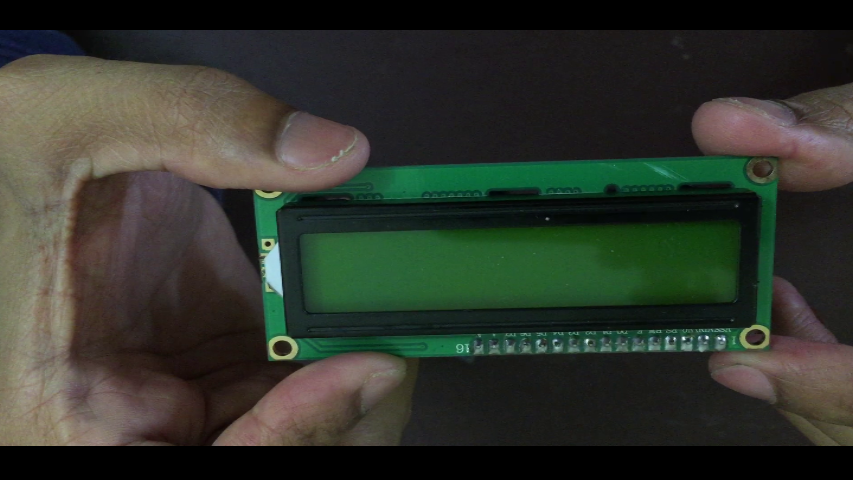

2 >> HD44780 16x2 character LCD.

Arduino NANO-The Arduino Nano is a small, complete, and breadboard-friendly board based on the ATmega328; offers the same connectivity and specs of the UNO board in a smaller form factor.
The Arduino Nano is programmed using the Arduino Software (IDE), our Integrated Development Environment common to all our boards and running both online and offline.
HD44780 16x2 character LCD-The Hitachi HD44780 LCD controller is an alphanumeric dot matrix liquid crystal display (LCD) controller developed by Hitachi that was commonly used during the MCS-51 era. It was made commercially available around year 1987.The character set of the controller includes ASCII characters, Japanese Kana characters, and some symbols in two 28 character lines. Using an extension driver, the device can display up to 80 characters.

The Arduino circuit connection for LCD:
* LCD RS pin to analog pin A0
* LCD Enable pin to analog pin A1
* LCD D4 pin to analog pin A2
* LCD D5 pin to analog pin A3
* LCD D6 pin to analog pin A4
* LCD D7 pin to analog pin A5
