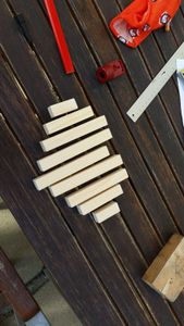

Step 1: Cut the Slat
The slat should be square.. i.e. width and height should be equal.
The length of the pieces you see in the picture depend on the dimensions of the slat.
In my case the width = 1.7 cm, so I needed:
2 pieces of 3 * 1.7 = 5.1 cm
2 pieces of 5 * 1.7 = 8.5 cm
2 pieces of 7 * 1.7 = 11.9 cm
3 pieces of 8 * 1.7 = 13.6 cm

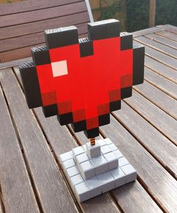

Step 2: Assemble the Heart
Unfortunately I didn't take pictures when I assembled the heart. The picture you see is the end result (with the first paint on it)
Please see step 4 of the Instructable of the Sword. I used the same method to assemble the heart.
One exception though! The last piece I just glued, I didn't use screws to avoid any screws from being visible.
Sand the heart again if you want a smooth end result.

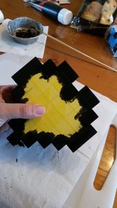

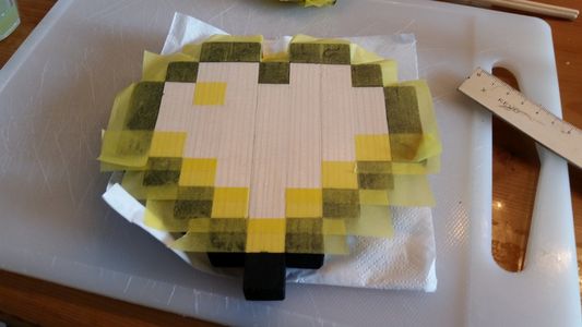

Step 5: Paint the Heart
This step is also pretty self explanatory. (see the instructable on the sword for some tips)
Step 6: Finishing
As with the sword, I sprayed the foot and the heart with a thin layer of varnish.
