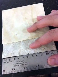

Step 5: Mark Dimensions
- Remove all over your nails once the rawhide is all the way dry.
- The two sides of the rawhide are different in texture.
- One side will be clean and more smooth.
- The other side, or backside, is more rough and "fleshy."
- The side you want facing out is the clean side.
- With your pencil and straightedge, Draw your straight line on one short side of the rawhide. This is the beginning of the rectangle.
- Using this line as something to square your straight edge against, draw lines on the long sides.
- Draw your last short side line to complete the rectangle.

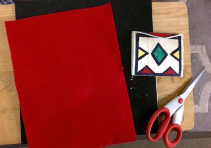

Step 12: Cut and Punch Felt Side Ribbons
- Cut two felt strips that are wide enough to fold around the left and right edge of the Parfleche.
- They only need to reach around enough to meet the edge of the painted design.
- Let them be slightly longer than the body of the parfleche.
- Cut a triangle notch in the bottom of each ribbon.
- Fold the over, and while holding them next to each row of punched holes, mark the location on the felt with the sharpie.
- Using the leather punch again, punch the felt while folded in half.
- Keep track of which side both ribbons are marked for so the holes will line up just right.
