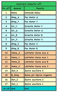

This board allows you to control 4 stepper motors, as well as receive input from two limit switches/ motor and from an emergency stop button and has a relay spindle interface for spindle motors.

Now to make 5 wires from 8 wires will have to connect all the neg wires between them and make a single wire.
Now we have 5 wires that we can connect to the controller driver board.
The cable wires between the motors and the controller are 1.5mm thick so that they wont heat up.

Next will have to configure the motor outputs from the ports and pins menu. As you can see I have entered the corresponding pin number for every motor step and dir. This information comes with the controller driver board.
Now that we have the pins configured we have to configure the limit switches inputs and the input of the E-stop. This information also comes with the controller driver board.
