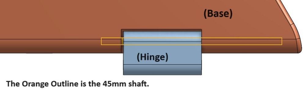

Step 1: Cutting Metal Rods for Hinges
Materials Needed: Wire metal coat hanger (Diameter: ≈1.75mm).
Steps:
  1. Measure (4) 45mm sections of the hanger.
  2. Cut them with pliers cutting edge.
  3. Make sure they are as straight as possible.

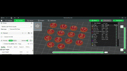

Step 5: Printing Procedure: Number Tiles
There are 2 number tile files Black Number Tiles & Red Number Tiles. Both Number Tiles share the same print settings and pauses the only difference is the color of the filiment used in the swap.
Materials Required:
  • (18) magnets (.25in Diameter x 0.0625 in Height)
Print settings for number tiles:
  • Support enabled.
Number Tiles Printing procedure:
  1. Load white filament into the printer.
  2. Load one of the Number Tiles files into the slicer.
  3. Slice
  4. Use a layer selection tool to find the second layer the numbers are being printed on and add a pause.
  5. Slice again if needed.
  6. Print.
  7. Once print pauses swap filament for either red or black depending on the file currently being printed.
  8. Purge out filament until the color changes.
  9. Resume print.
  10. After successful printing, remove supports from the hole and superglue magnets into place.
  11. Be sure to place all magnets in the same direction.
  12. Print the other Number Tile file following steps 1-5

Step 9: Assembly of Board
Assembly of Hinges.
  1. Use the 45mm shaft cut hanger pieces and put them through the hole and hinge.
  2. Use another shaft to push it in fully.
  3. Heat up filiment and use it to plug the hole the shaft is in.
  4. A 3D printing pen is a great way to accomplish this cleanly.
     4. Repeat this for the 3 other shafts.
