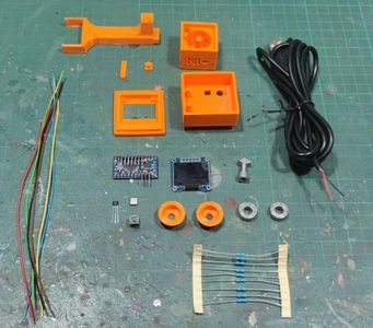

To carry out this project you will need a 3d printer, hahaha, really? Well, and a few more things:
(I do not use referral links so these are merely informative, however some of the ones I attached were my own purchases and others just similar, if you need more help, let me know :)
- Arduino pro mini 5v 328p

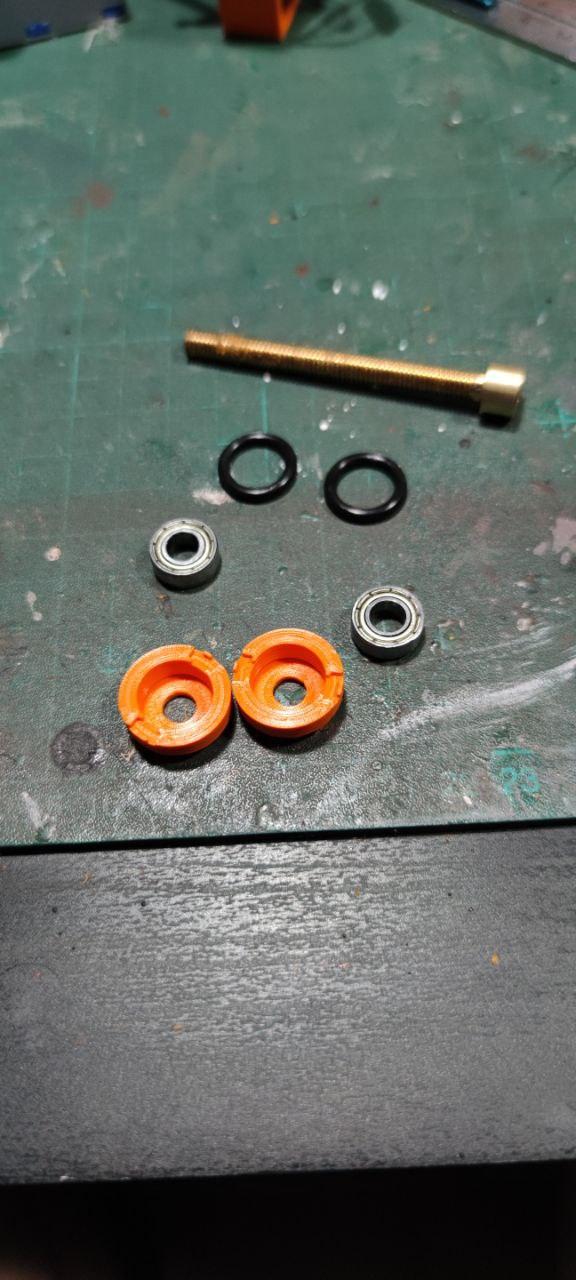

- 2 686zz bearings (13*6*5)
- 2 neodymium magnets 5x5x2mm
- 1 oled screen 128*64 SPI
- 2 o-rings ID 11mm CS 2,5mm (I recommend buying the O-rings in any vehicle spare part, since sell a lot of them online and only need two, but I leave a link so you can see the model.)
- 1 Hall Effect Sensor
- 1 10K resistor
- USB Cable
- Mobile charger
- Terminals for the connections (although you can solder directly)

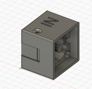

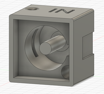

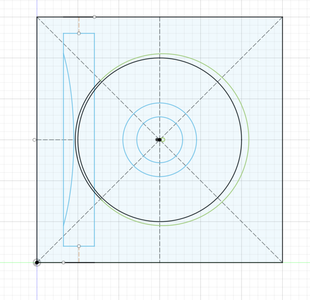

The design has been made with fusion 360, the truth is that it has been wonderful to be able to make changes quickly and efficiently once the design was finished. Accustomed to tinkercad... it's another level, without detracting from it at all.
The fittings of the pieces are made, so that they do not have to be glued, they fit just and hard enough so that they do not come out by accident.
You should print one of each and two of cone2 magnet2.
The supports, which I include one for you to adapt to your liking (adaptable support) one for the Artillery x1 (which is the one I use) and another for the ender 3 v1 (I had one on hand and I could check the design) For the rest, It will not be difficult for you to place it anywhere, given its small size.

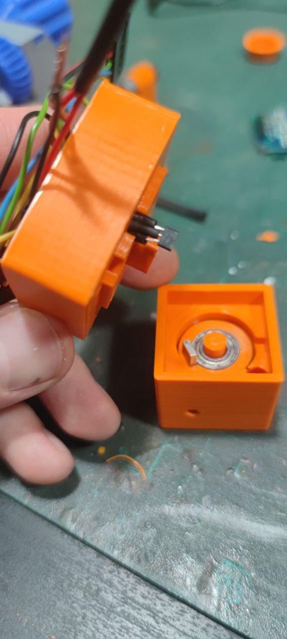

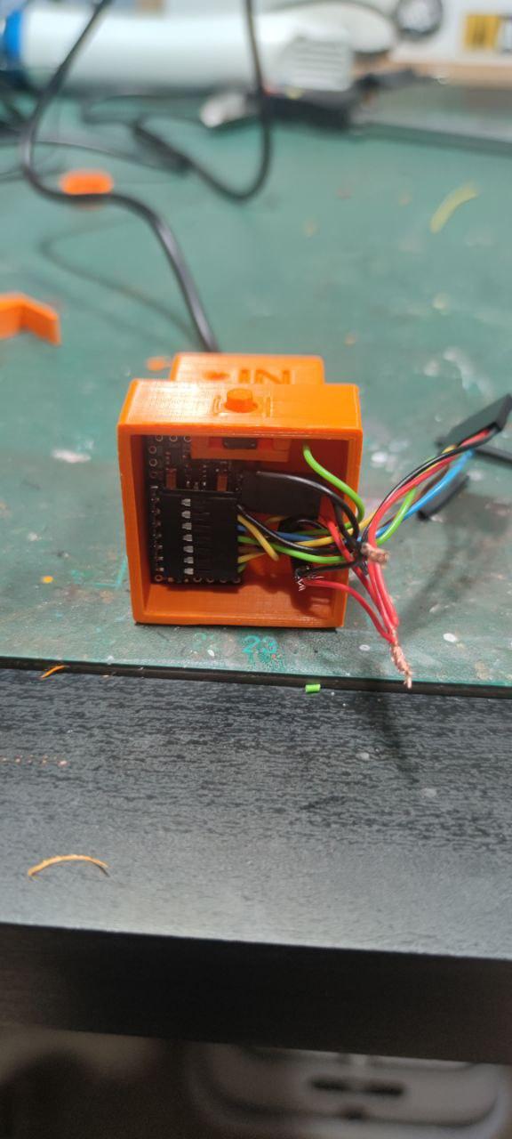

The assembly is quite simple and intuitive, I have added a few photos to serve as a guide. The electronics are quite simple, a button, a screen and a sensor. It is true that the space is reduced, but there are not many connections. Take into account the orientation of the pins on the pro mini board and take advantage of the back of it to solder the 10k resistor that goes between VCC and the hall sensor pin.
El montaje es bastante sencillo e intuitivo, he añadido unas cuantas fotos para que sirva de guia. La electronica es bastante simple, un pulsador, una pantalla y un sensor. Es verdad que el espacio es reducido, pero no son muchas las conexiones. A tener encuenta la orientacion de los pines en la placa pro mini y aprovechar la parte trasera de la misma para soldar la resistencia de 10k que va entre VCC y el pin del sensor de hall.

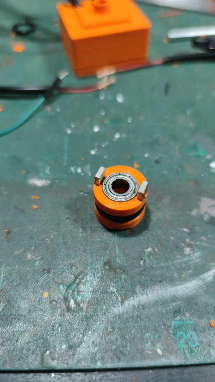

The operation is simple, the filament is slightly forced against the rubber of the O-rings, these make the cones rotate on the bearings and move the magnet, which, when detected by the hall effect sensor, adds half the length of the circumference ( (2*pi*r) 2*3.14*10) half because it has two magnets. The upper button resets the account.
