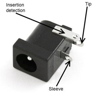

  1. Check the pin specifications of the barrel jack. Normally, The center pin is positive and the surrounding coaxial is negative. Be extra sure by using a multimeter to check the voltage after connecting the barrel jack to the power supply, as I've done in the picture above. Some barrel jacks could have inverted polarity, and this could damage your components!

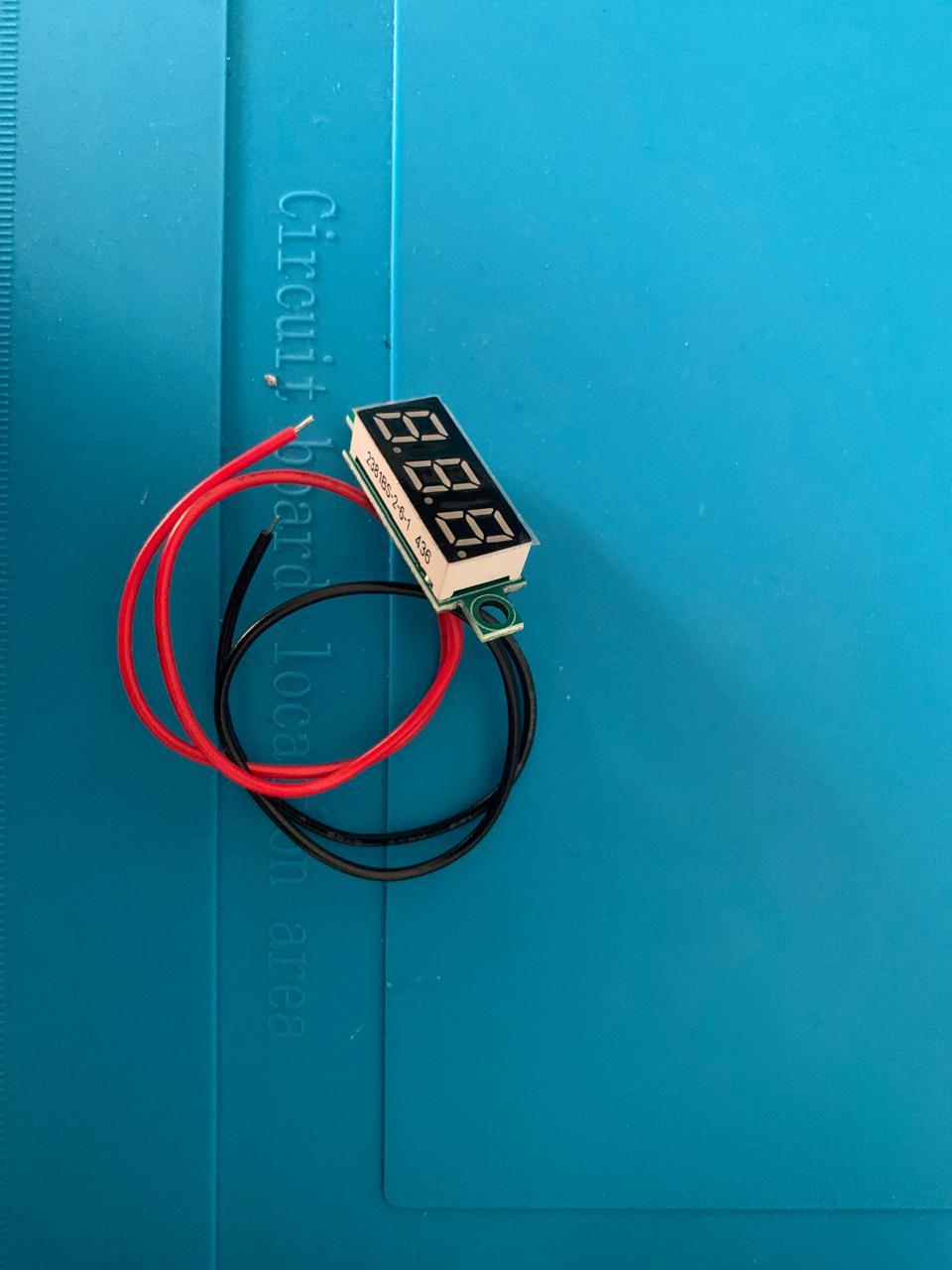

If I had gotten this earlier, I wouldn't have had to do any of the power supply calibration and scale. But I bought this after the project was halfway done, and just couldn't pass up on adding this to my little power supply. I've edited the Supplies list and the schematic to reflect these changes.
The wiring for this 3-digit voltage display module is easy. Just connect the wires of the display to the output voltage of the power supply (after the filtering capacitor, otherwise it'll show inaccurate readings), taking care for polarity. This display saves me the trouble of having to double check the voltage output with my multimeter because of my trust issues!
Note: Below 2.5 V or so, the screen does go blank. The scale is important for these parts (although nothing I ever build really does go below 3.3V anyway). Also, I ended up removing the indicator LED, since the screen is the indicator now, and I didn't want too much excessive current draw.
This part is entirely optional and can be skipped without any major consequence. However, it's best you include at least one, either the screen or the indicator LED.

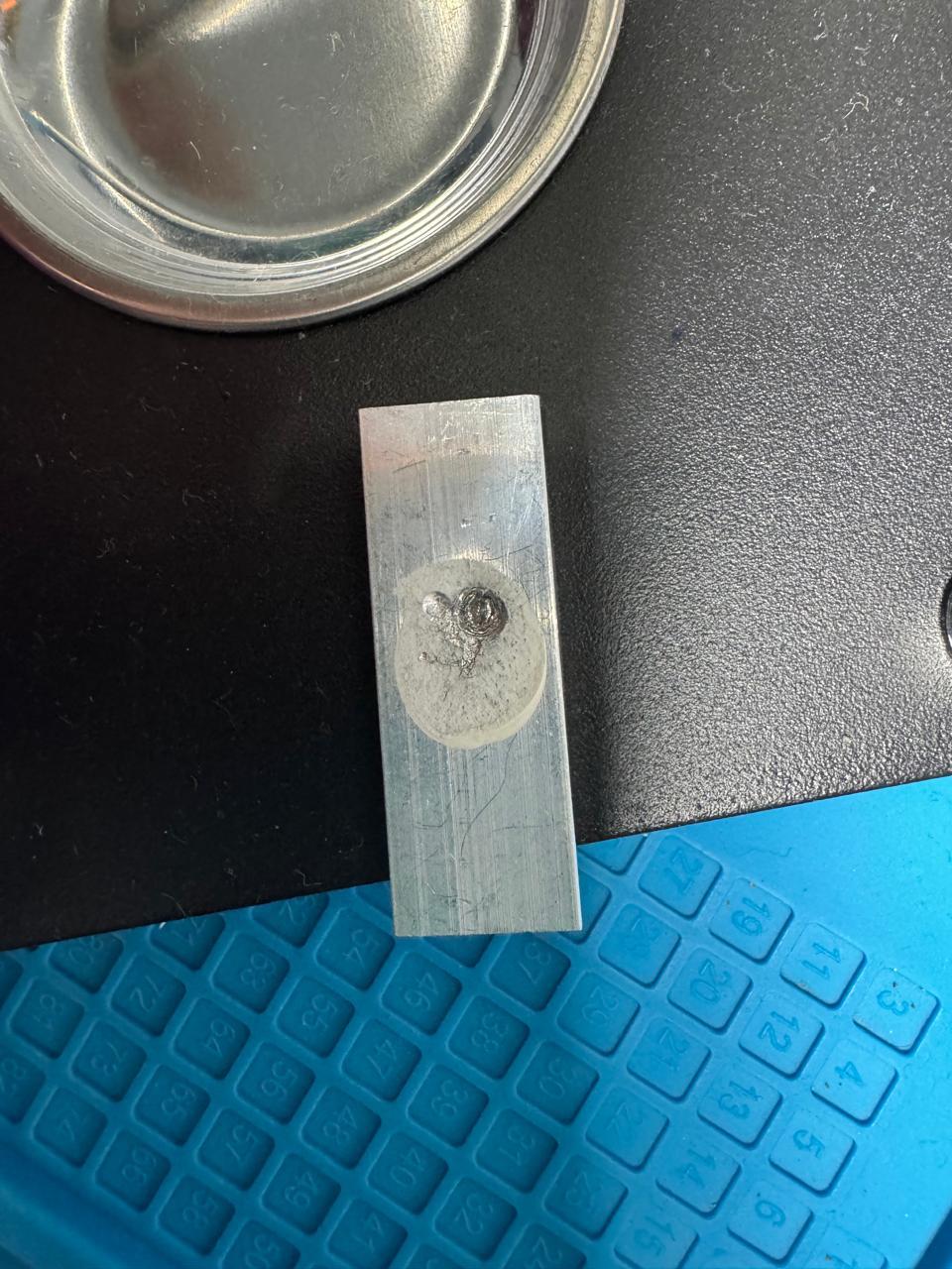

I resorted to some really crude methods to get this stage done, such as hammering into the heatsink (Image 3). Which is why I'd advise you get a heatsink with a screw hole! Step 1 already highlighted how important it is we add a heatsink.
For this part, you'd better ensure your LM317's back face is facing the hole you cut out for the heatsink (as in Image 1). Then, hot-glue the circuit board in place (take care not to damage components! I broke my board's diode once). I also glued around all the wire connections on the circuit board to prevent any accidental short circuiting.
Now for the heatsink. Do NOT cut corners on this step and try to do something like hot-glue or superglue the heatsink. This will prevent proper heat transfer and cause the LM317 to overheat and fail, which will be an absolute pain to replace. Do it once, right! Acceptable mounting methods are:
  1. Screw tightly (best option)
  2. Paper binder clip, held tightly
  3. heat resistant epoxy (ensuring the metal tab maintains contact with the heatsink)
  4. Thermal glue
If you have some old CPU thermal paste, it would be best to apply that too.
I must also warn you here, the LM317's heat dissipation tab is linked to its V-OUT pin. Do not let the heatsink touch any other wires, or it will short circuit!
I'm going to use epoxy hardener in a bit to connect the heatsink to the plastic case, to prevent it melting.
You can see my final wiring setup in Image 2. The exposed section of wire is common ground. This is really the last major step (the rest are just finishing touches).
