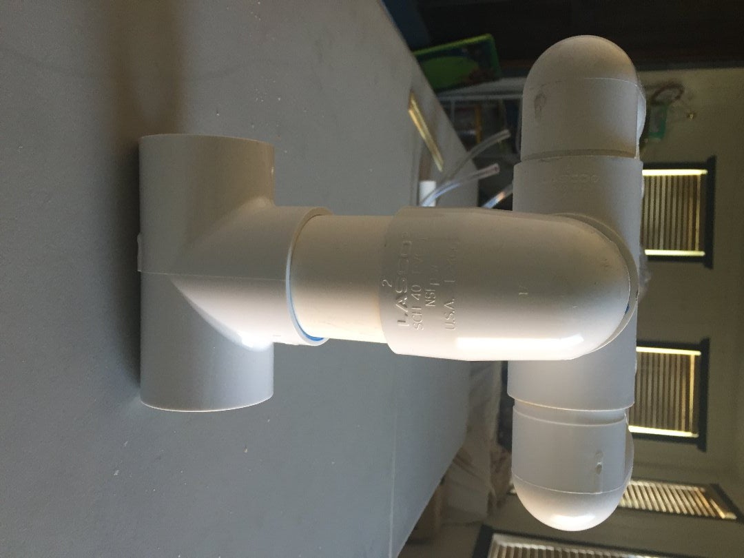

Originally, I had the instructions written out but they didn't get saved. Then I thought to myself that written instructions for this kind of work may be difficult so instead I drew up some schematics. I included the schematic for the fittings and how everything fits together and where to drill the holes. please refer to the other images of the system if needed.
Note about the holes: The 1.5" holes are where the pots would be and the plants are. They should be spaced evenly on the 2" pipe. The 3/8" holes are for the vinyl tubing. You may have to scrape along the edges of the holes to make a tight fit with the tubes. I recommend=d sanding down the 1.5" holes.

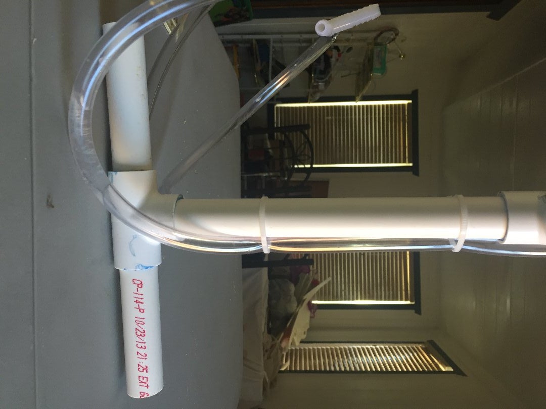

Insert the tubes into the 3/8" holes and direct them into their respective 2" section. zip tie the tubes onto the PVC pipe and connect to the 3/8" barbed cross.
