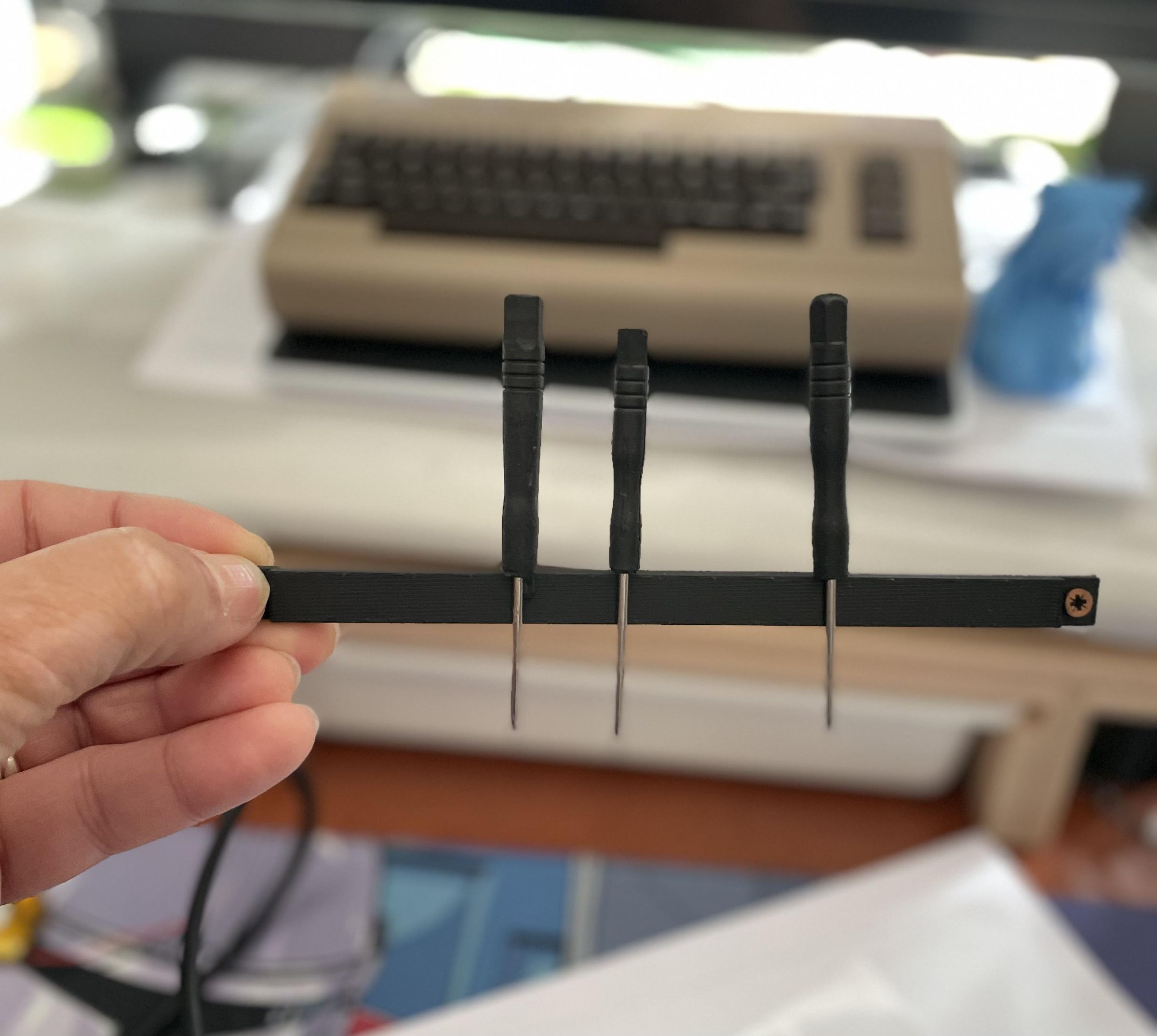

Step 3: Schema
Step 4: IPS 2.8" Display Assembly
Steps to connect the 2.8-inch display:
  1. Gather the wires: Get colored wires with a 0.25 mm² section. You will need at least 9 wires, including red and black for power supply.
  2. Prepare the wires: Cut the wires to the required length and strip the ends. Make sure to carefully prepare the red and black wires for the power connection.
  3. Soldering the wires: Follow the soldering diagram shown in the reference photo. Solder each wire carefully to the corresponding pins on the display, paying attention to correct polarity and connections.
  4. Apply heat shrink tubing: Before completing the soldering, slide a piece of heat shrink tubing, about 1.5 cm long, onto each wire. Once the wires are soldered, slide the tubing over the solder joint and use a heat source (like a lighter or heat gun) to shrink the tubing, protecting the solder joints.
  5. Assembling the case: After completing the connections, follow the reference images to insert the display into the 3D-printed case. Ensure that the wiring passes through the designated spaces and is neatly arranged.
  6. Closing the case: Close the case as shown in the pictures, ensuring all wires are correctly positioned and the display is securely housed.
