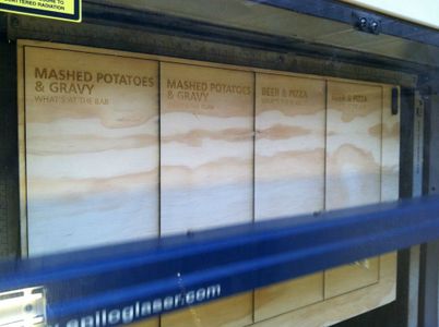

Each board was identical except for the name of the table at the top. I set up a template and just copied the name across the top of the boards. While the laser cutter can cut through wood this thick, it takes multiple passes as leaves a scorched edge so I recommend cutting the straight edges on a table saw.
The laser cutter I used can be fickle, so parts of the text needed to be etched twice.

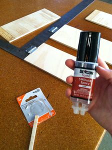

Assembling the hinges on the boards just requires 5-minute epoxy and a straight edge.
Apply epoxy to one side of the hinge and one board. After that is set, line the boards up against a straight edge and apply the epoxy to the other side of the hinge and partner board.
We had linens on the table so there was no need to make sure the boards wouldn't slide with just a hinge, but you could add a base or connect the boards with a ribbon to make sure it doesn't slide open wider than you'd like.
