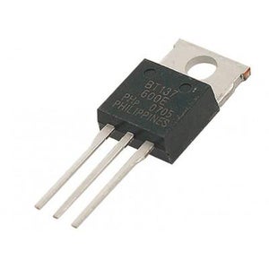

- BT136 - 1pc

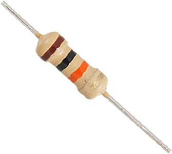

- 10k resistor - 1pc

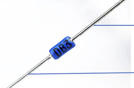

- DB3 Diac - 1pc

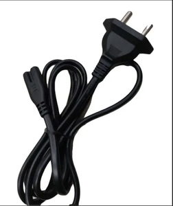

- AC power cord - 1pc

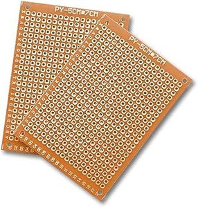

- Perf board - 1pc

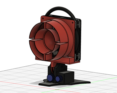

- 3d printed parts

Step 2: Tilt Control Preparation
Insert two M3 screws inside Tilt control part as shown in pictures to give the part more strength.
Step 3: Top Part Assembly
Combine Tilt control and Air guard parts with four M5 screws.
Step 4: Tilt Knob Preparation
Insert M3 screw to Tilt Knob to give extra strength. This part is responsible for vertical alignment.
Step 5: Body Assembly
Assemble the body by combining Top and Base parts as shown in pictures. Place Tilt knob between two parts.
Step 6: Back Cover Assembly
Place plastic mesh between back cover 1 and Back Cover 2 and apply glue.
Step 7: Fan, Handle, Back Cover Assembly
Assemble the Fan with 2 M4 long screws and 2 M4 short screws at the bottom. Add Handle and back cover in the process. Do not miss to add handle spacers.
