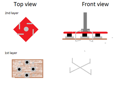

As I mentioned earlier the joystick is really tricky. I attached a sketch (sorry, it's made in Paint) how it's assembled. it's actually just 4 switches and a flat piece of Lego (without edges) secured together with clips. (it's great because I didn't needed analog conversion for the D-pad). The rod of the joystick is glued into the hole of the Lego. I secured the 4 switches on a soldering board. I trimmed down the edges of a flat Lego piece and put it on top of the 4 switches. Then I took 2 gem clips (not the colored ones) and made an x like in the sketch. I secured together the whole joystIck with it, even made a small cut at the side of the lego piece just to make it more secure.
