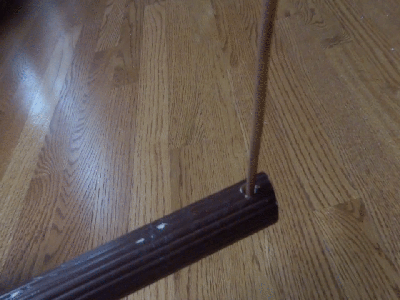

Start by making a winding tool by taking a 1.5-3in wooden dowel and drilling a 1/2in hole straight through the dowel at the end.
Before you start winding the coil, fill the tube with salt. This will prevent the tube from kinking and increase the rate of flow through the pipe.
Now, take the beginning of the copper tube and put it into the hole you drilled. Take the tube and slowly wrap it around the dowel. When you run out of copper tube, cut the tube close to its starting point.
Use water to disolve the salt from the pipe.

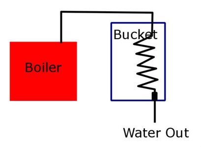

Step 4: Connect the Tubes
Begin by fitting the silicone tube around an end of the copper coil. Use hose claps to ensure a watertight seal. The other end of this tube should connect to the gland in the bucket, your clean water output.

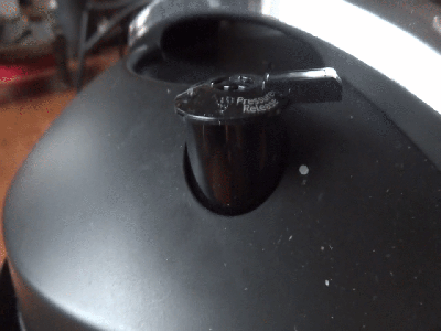

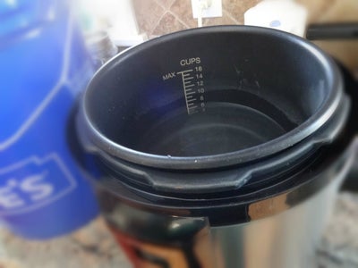

Now, Remove the whistle of the pressure cooker and fit a length of silicone tube to it. Attach the other end of the tube to the open end of the copper coil.
See the diagram for detail

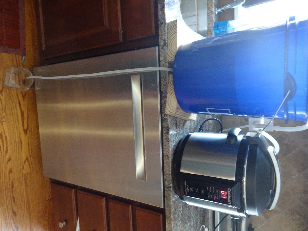

Step 5: Running the Water Distiller

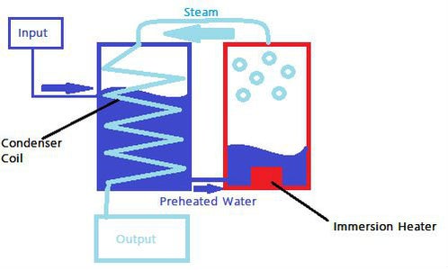

Start by submerging the condensing coil in the 5 gallon bucket with cold water. Put you dirty water inside the pressure cooker and start it up. You should be producing a steady flow of steam after about 10 minutes. Look closely for any leaks as it could contaminate your water output.
Yay! You should now have a steady flow of clean water coming out the output pipe. When the water in the bucket starts becoming very warm, replace it with cold water again, and put the preheated water into the pressure cooker.
