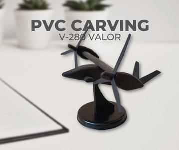

We recently had a "Cubicle Day" competition at work, for which I decided to make this miniature model of the Bell V280 Valor aircraft. There were two reasons behind choosing to make this. One is that I have been using PVC board (also called sunboard) for a lot of projects lately. It is a sturdy material yet soft enough to cut with a craft knife. So I thought if I could sculpt something out of this material. And another reason is that I work in the company that makes the actual V280 aircraft (surprise, surprise) so this would impress the judges.
And guess what? I won second place in the competition! Not to brag, but I got a lot of appreciation for my carving skills (pretty neat since this was my first attempt at it). So let me show you how I made this.

I glued a small neodymium magnet to the bottom of the fuselage to attach a metal stand. Initially, I used a bent strip of steel as the stand, but it looked quite ugly. So I later built a stand out of a plastic lid and some more PVC board and painted it black. Then, I stuck another neodymium magnet to the top of the stand so that the aircraft can snap into place.
PVC board is very durable and this piece of art will last quite long for sure. The only thing that can fade is the paint. But you can always spray paint it again.
